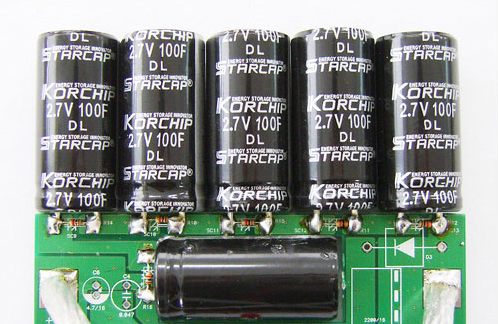

The following picture internal look of Supercap VS made by Korea company. The total value are 16.2 V only. However there didn't show the diode in this picture and there actually have place to insert diode and some hole for the small cap capacitor.

Any idea why the Korea maker put the Super Cap in series? It is because those Super Cap only comes in low voltage?

Yes you are right super cap are only comes in low voltage & normally these cap are commonly 2.7v,5 v&5.5 v. If you have the pivot VS try to connect it direct to ignition coil. Then you should feel the different and I explain this in diy ignition booster thread.
