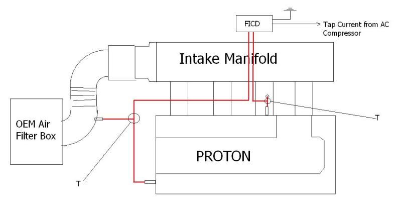

interesting mod but why don't you just hook the FICD with some 10mm hose to the intake directly?
1-The messy flying hoses pissed me up everytime I see them
2-longer hose will have slower response. Actual hose size is 8mm. 10mm will get lose very fast.
3-removing the water passage makes my engine lighter, since the water is used to prevent throttle freeze/jam in the winter n we don't have winter in Malaysia.
4-Without removing the ISC, it'll still run without control. Unless u unplug the socket.
5-doesn't wanna share too much vacumn line to the same source. It'll affect other devices that is sharing the same vacumn line if not connected properly.
6-want to maintain the blow off sound without having to drill another hole onto my IC piping.

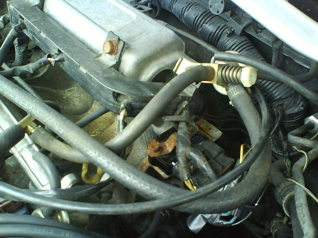

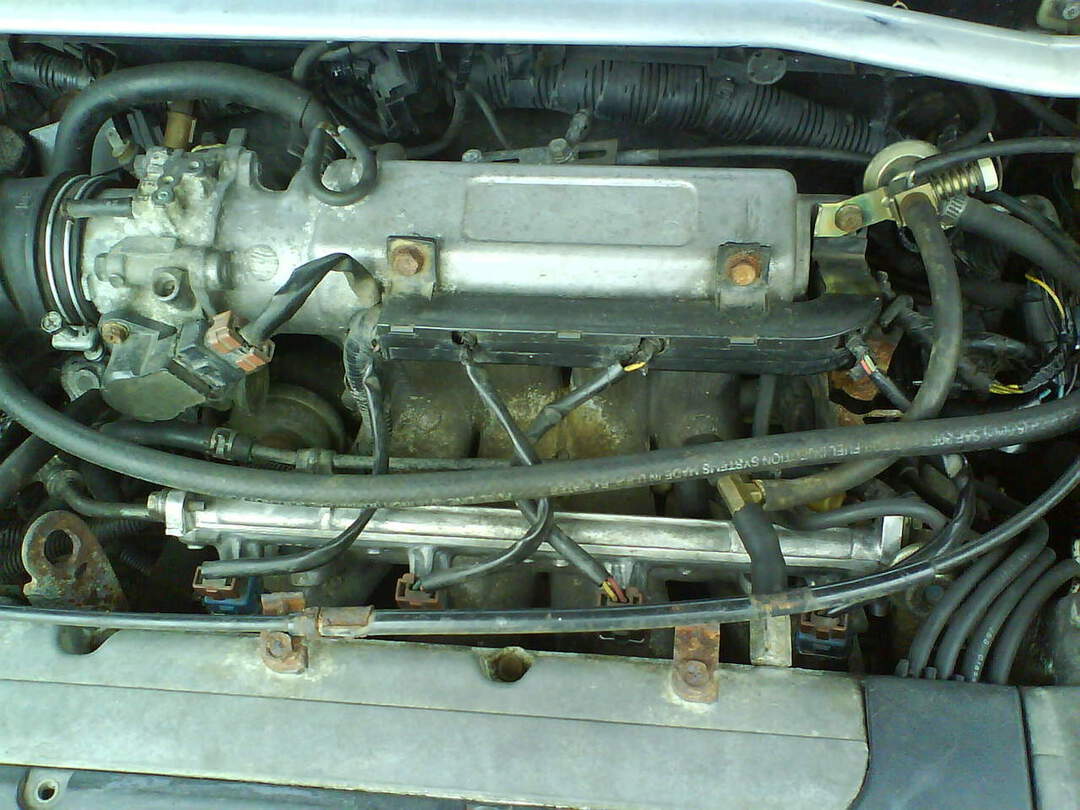

i read ur thread. a bit confusing for non technical guys like me but i roughly get the idea. which one is the FIDC in the pics? btw, my mechanic has installed a FITT which is a buncha hoses and a valve to allow me to adjust the timing when aircon compressor kicks in. i can turn the valve to adjust and it prevents my engine from stalling (i have a problem that the engine rpm drops sometimes twice in a row when throttle is not open. FITT prevents rpm from dropping until engine stall)

err... Confusing ka? Nothing much actually. Just get the water passage removed completely, print out the drawing with 7 holes and send it to
engineering shop. Get the plate mounted substituting the ISC mount block with water passage. And get the FICD connected.
FICD is the black color device beside the TB.

If u dun mind flying hoses in ur engine bay, here u are.

where can i get the FICD and how much would it be? my FITT connects to the points in ur drawing so i m not sure if i should touch them. haven't got the time to take the pics yet. will update wif pics when i can.
