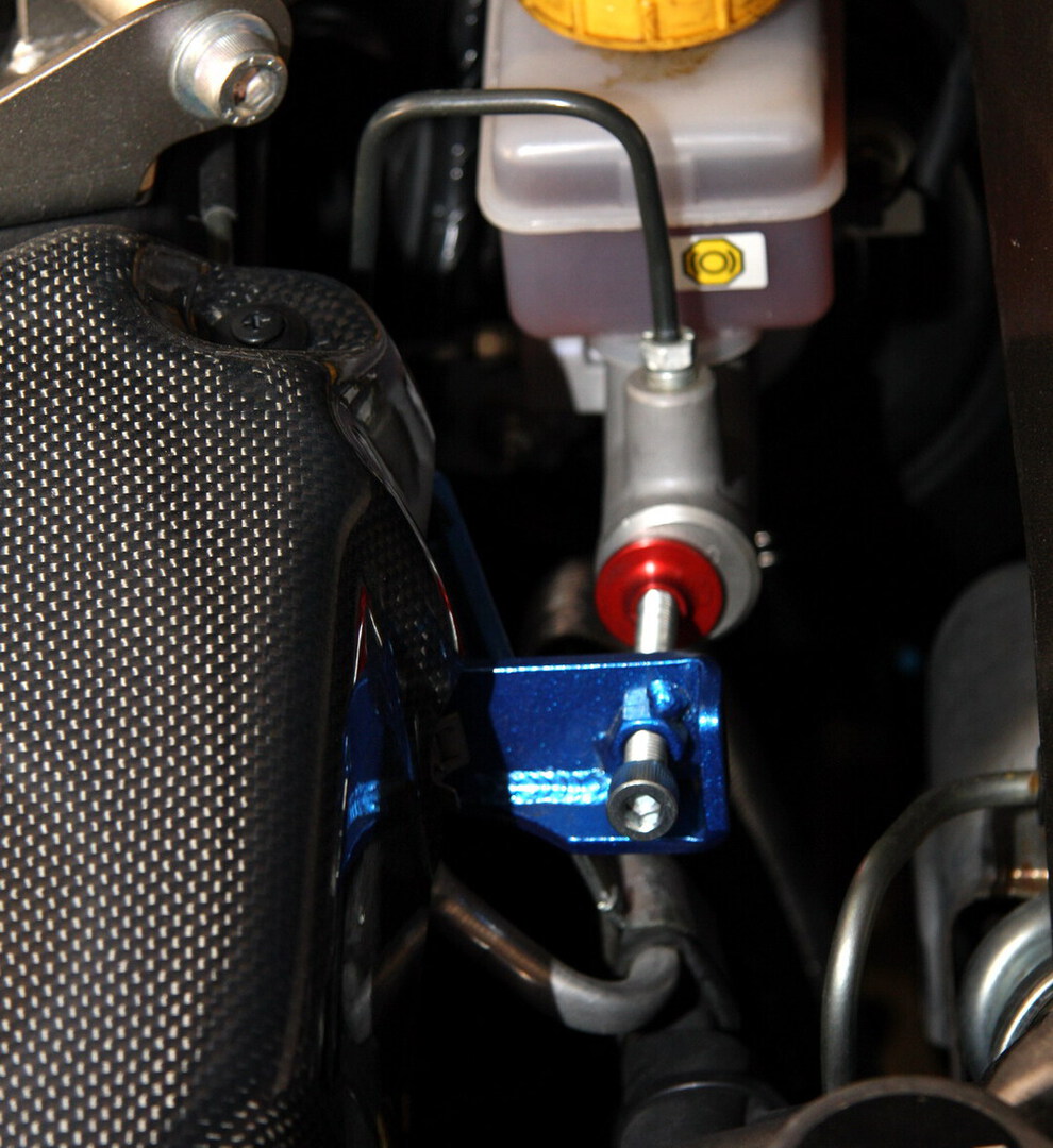

Could you elaborate a little how this brake stopper works to improve braking performance?
Thanks.
Thanks.
Brake stopper works like giving u more harder pedal feel by minimizing firewall flexing when u pressing the pedal, give u more precise control over braking.

3. Brake stopper. These little things stop or lessen the firewall flex when the servo is active giving you better brake pedal feel.
