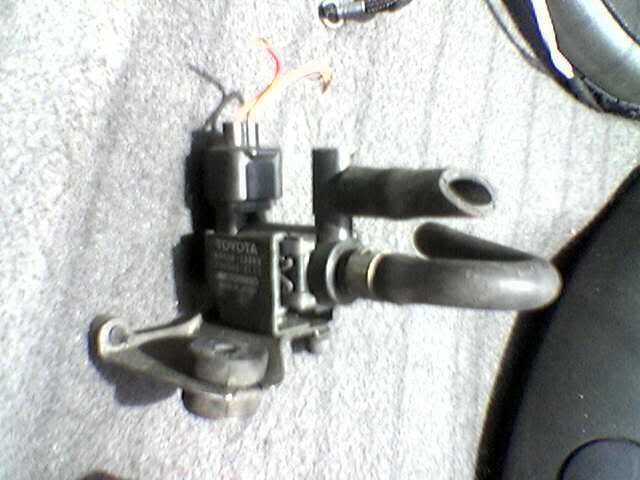

yes im using silvertop, erm ficd? i heard lst time there is toyota sifus doing this service but i will double check with my mech, thks for the advice i will mention to him bout this ficd..., one more thing there is someone in the forum i forgot his name already saying that he have some gadget to helps stablise the engine if we face the problem,what do you guys think, that gadget also have toyota printed on its body but forget already who that guy is liao ehehe, anyway thks guys

hahhahah.....
i have AFM for sale.
