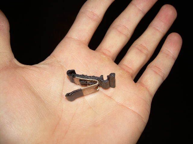

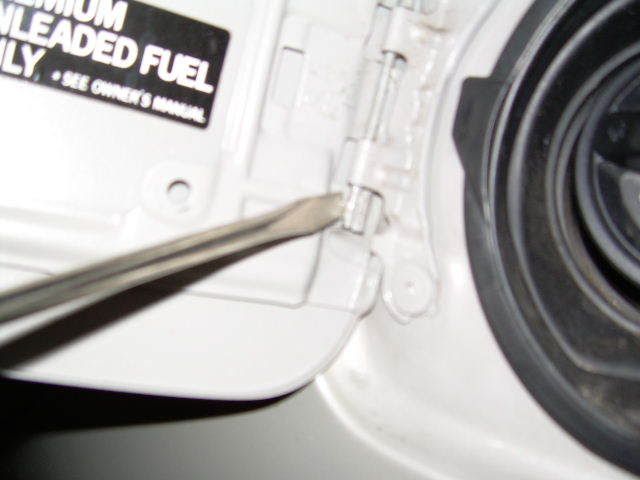

3) With screwdriver placed under this "spring lever thing," pry up. It will pop right off.

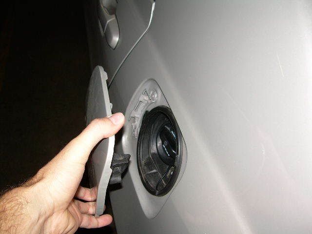

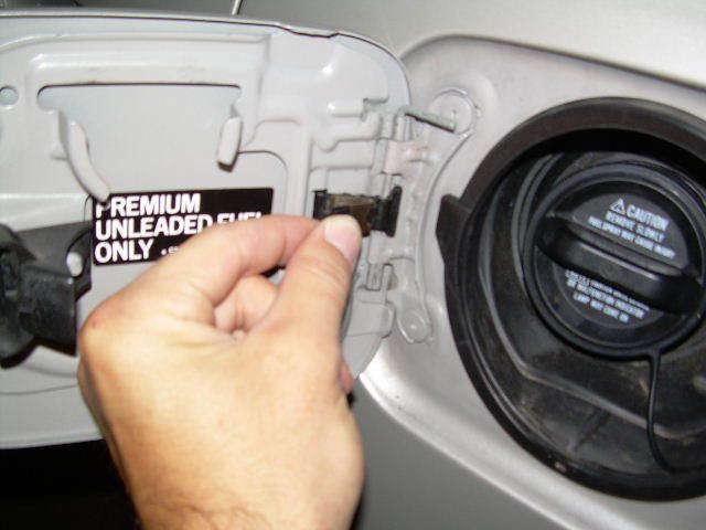

This is what it looks like when off. It just has a circular cut out that is push fitted onto the hinger bar.

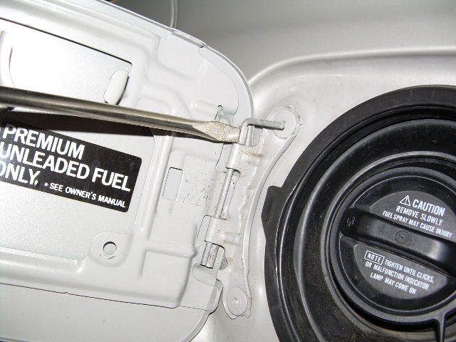

4) Next, use the flat screwdriver to bend back the top tab so that it clears the hinge bar.
5) Next, use the flat screwdriver to bend back the bottom tab so that it clears the hinge bar.

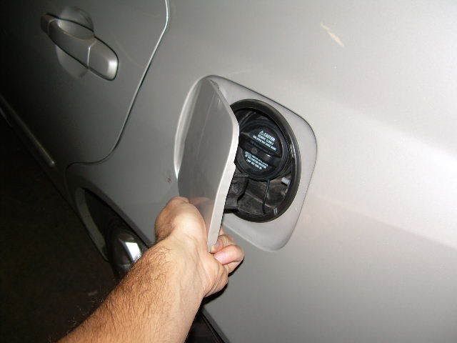

6) Close the gas door to about 30-45 degrees and push toward the front of the car so that the tabs you just bent clear the hinge bar. Close more if needed.
7) Pull outward and the door is free.

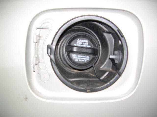

8) Congrats, You're done!

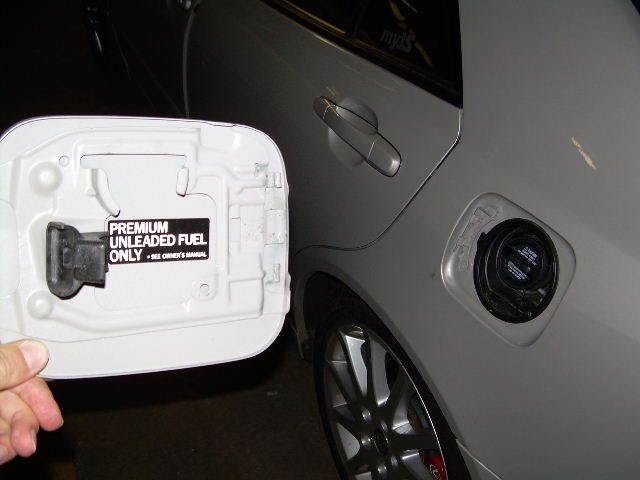

is that IS model ?
i just wonder, why mine does not have the fuel cap holder on the back of the
fuel cover lid while the one in the pic has ??
mokh
Oct 18, 2008
226
14
yes..pictures is IS model. however, the door hinge is still the same. this tutorial valid for all altezza/IS200/IS300 model.
