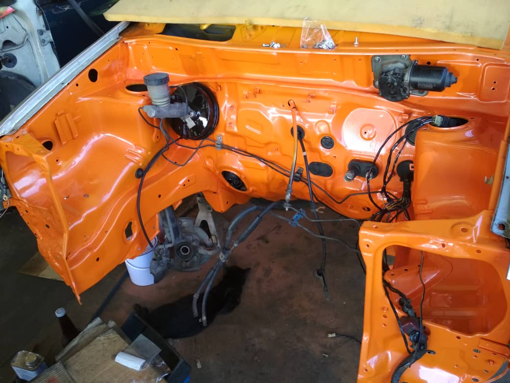

Project Kancil Moderno with EJ1000 TD04L
Bro, my mechs advice to me to go by step as the base engine is not a turbo engine but NA. Bolt On needs to go by steps as the engine might not to be able handle the boost and power produce. Cannot simply push to the limit as the risk of engine failure is high. When the engine system running stable with the boost and power, it can be upgrade higher but accordingly.

My mechs suggest a compressor from Mira L5. All the aircond pipings will be redesign as the car battery already transfer to the rear trunk. Therefore, all the aircond stuff will be put on the left ( Passenger side ).
That doesn't quite make sense. I mean, if you set it up to run at 1bar boost for now and "upgrade later", how are you going to "upgrade higher" later unless you take everything out and reinforce everything again? Why can't you get all the reinforcing done now (like forged everything, stronger cylinder liners, injectors, etc) instead of taking things in and out everytime you want to upgrade?

I trust my mech as they didn't take any advantage at all. We maybe know the theory and such, but can't compare with experience. Like i said, i'm more concern on reliability for use both track and road. You think fully upgrade track car be running for long distance road use? I want to make it balance. Even i'm going to upgrade later.

here's some of my thought. So far its a good built as the mech knows some weak part and change to new parts such as all bolts and nuts.. FYI, Close friend of mine crank up the boost up to 1.8 bar on 72mm kelisa piston and stock L2s conrod and bottom. Rembat here and there till gearbox kong but the engine won't break at all and even works fine for few years until recently total lost accident. So in your case, u can also pick 73mm low comp piston for extra bore and extra HP thus it would make your big td04l gsr be more responsive. My concern here would be your turbo response and conrod as it still stock but as u mentioned earlier to set max 1.8 bar boost so it would be just fine.
Modifying this DOHC EJ head would be a pain in the ass as there's not much aftermarket performance part. ur mech can try rojak it but i dont have idea but i know there's a performance camshaft from matspeed for EJ DOHC head. i know all those drag monster rojak to L2s head and get more HP, but it's all up to owner to choose. last but not least, u have to get a LSD for ur monster as stock open diff will give u hard time finding grip during launching and getting out of corner.
