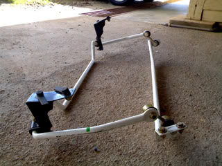

Disagree bro SC. The 3MAX rear ARB design is different compare to UR. And you look at the front lower brace bar, UR (4points) & Dsport (6points). The Dsport having a better design and the performance should be different. Need bro Ixeo to clarify this.
@cvkit, previously saw ppl post at forum saying that the 3Max rear ARB is good but the mounting points broke or cracked due to 3Max design. Too many force to the mounting and causes it breaks.

If you look at the design of the bars, 3max uses the standard droplink - antiroll bar - connected to lower arm design. It's sort of working in tandem with the torsion beam. So the rear design from "H" pattern is now a "U" design (sort of) with the majority of the body roll being transferred to and from the drop link / ARB. That's a lotta force so if you drive hard enough, the anchor points where it's connected to the chassis will end up absorbing most if not all of the forces, therefore snap or tear.
The thick UR torsion beam strengther same concept, reduce body roll by being stiff and again the anchor points are the ones that take all the force, therefore snap/break with enough force.
ARB in H design? I check and see got U design only?
I think sifu Izso is talking about this kind of rear ARB.
Correct me if i'm wrong.
