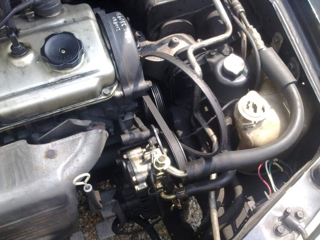

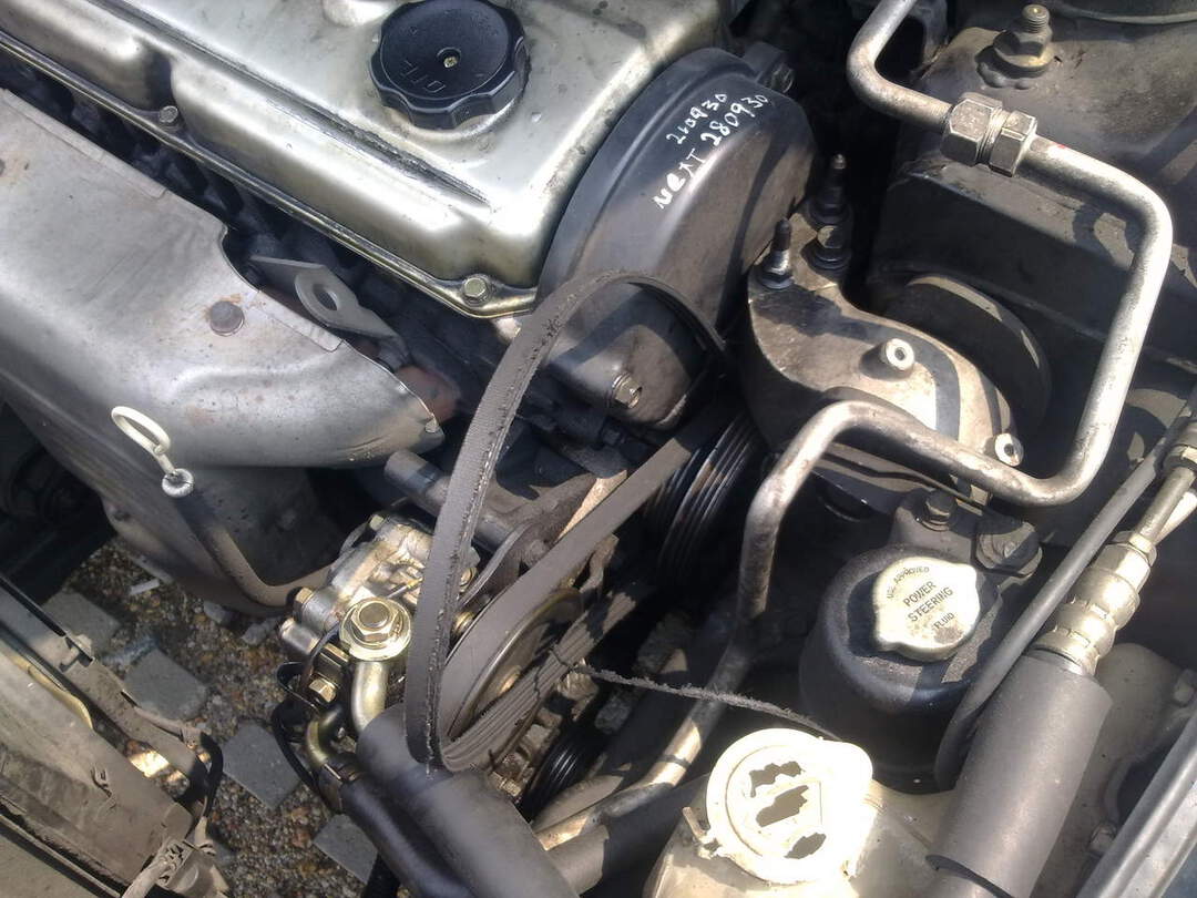

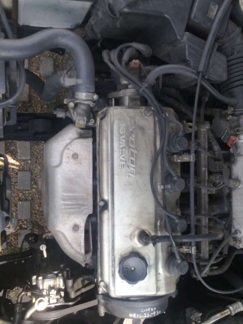

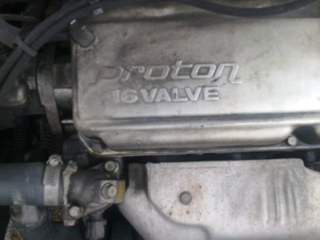

Hi Danz,
Thanks man,
Truly appreciate what you have rectified on the car issues.
I will be uploadin the engine pic tonight.
---------- Post added at 06:11 PM ---------- 6 hour anti-bump limit - Previous post was at 06:10 PM ----------
1.Spoiled engine mountings
2.Oil leak at the engine part (not sure where it is coming from)
3.Very Noisy Engine :banghead:
5.Clutch bearing
-The way i found out that the Clutch Bearing has issues is, when the engine is running,there will b a middle pitch rotating noise.And When i press the clutch,the noise silents.I consulted the mechs and they told that the Clutch bearing is almost spoiled.
6.Gbox Issue
-When i shift gears, it is very rough and at times, the gear does not sync
And i had asked the mechs and they told that they need to do further inspection on the car
7.Absobers worn off
8.Exhaust system
