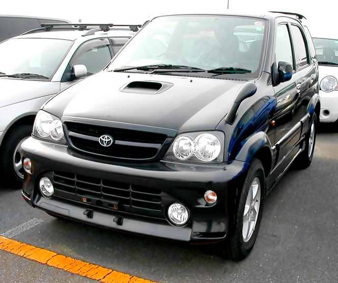

me using dvvt auto (timing chain) 05 toyota cami facelift.. personally.. it's a nice car i mean mini 4x4 ..
for FC + aircond with 3 passenger .. if 100% hiway then it's quite saving if not tekan over 110kmh.. full tank > 2nd last bar on meter (410+-km) (fulltank around rm80-90 i guess ron95)
if town driving + aircond + passengers.. quite kuat (auto)
aircond blower moto kinda noisy,but not really irritating but aircond A+ (sejukkk)
ICE : not bad speaker output with double din player. (SE model)
handling .. not so bad.. can take 45-50degrees corner angle even in 70kmh.. but if you're looking for comfortable.. these sweety is not really comfort, but not real bad, still can be family car aswell..
get in town driving is another things, absolutely nice, because you're sitting higher than other cars roof.. so can see much more ahead
all i can give for dvvt (mine ct aero with toyota cami facelift) from 5 stars is 3.5..
halfcut for turbo model around 6-8k's with installation
1.5>1.6 engine below 4k's i guess, gb still can used the old 1.. same ratio. same gb.
** u can convert your AWD 4X4 > 2WD **
reduce your FC + top speed + pickup aswell.!
