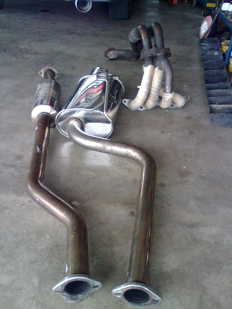

Want performance but in the same time not hurting ur ears, choose straight flow but with big barrel like l've attached..l've tried s-flow and my conclusion, it couldnt satisfy my expectation..quiet, yes but performance, need to step ur pedal even more to make the car moving

Sorry, when I said lighter I was referring to the general aftermarket exhaust piping, not just muffler. Muffler weight should be more or less the same...sorry2..
Performance wise, just changing your exhaust is not gonna yield much power difference, be it straight flow or not. Extractors, for example affects performance more than the exhaust.
agreed with you.. stock exhaust more pikap than s-flow even with aftermarket extractor.. erm..
