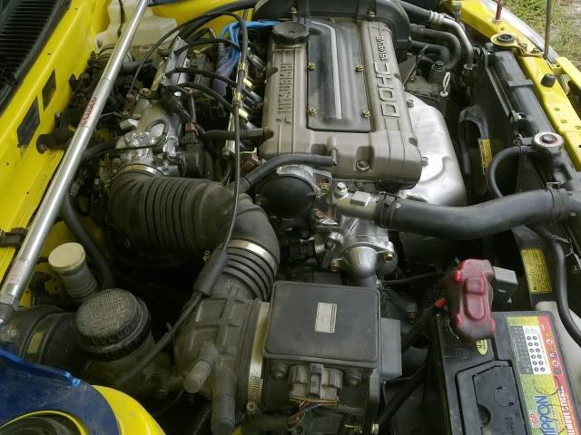

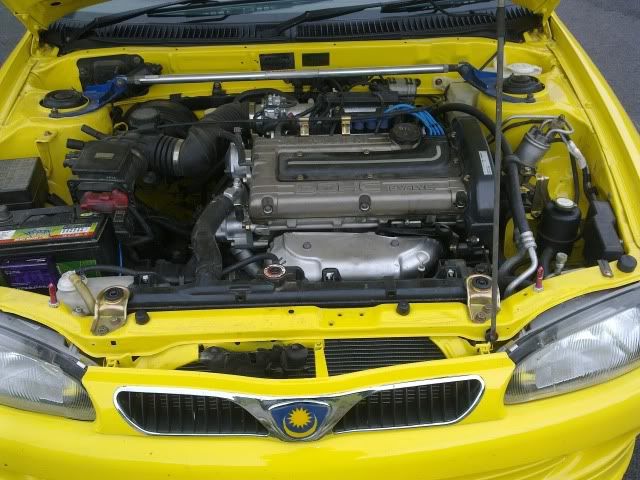

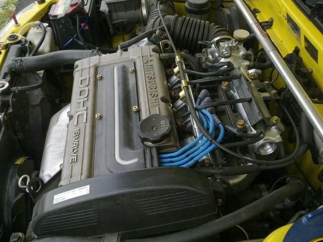

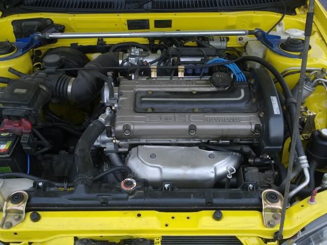

picture of engine bay attached

dats an original 2liter 63 sir, iam not sure if its the amg version though. performance is good though

original 2liter 63 from half cut. not an AMG version.

Very rare indeed if bought from chop shop.What I know there is rvr 2.0 na look similar with this.As we all know rvr doent have any distributor unit there but it can be modified to use evo wiring n cam.To confirm more about this engine,please check what piston type that this engine are using n please check the head marking on the head n the camshaft.
