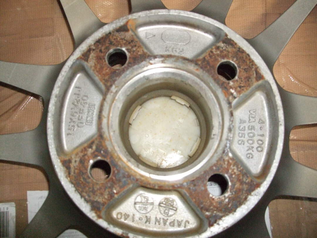

details about the back of the rim

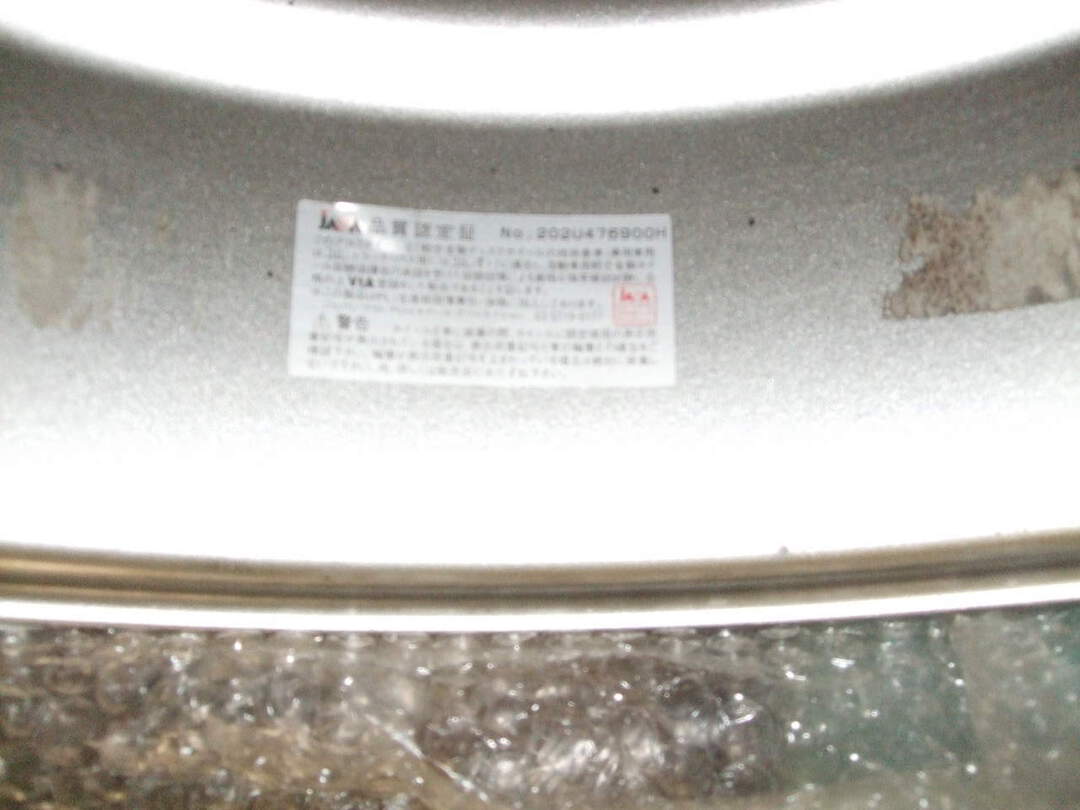

it has a jawa sticker and many japanese writings on it.
it also had engraved telling it's japan.
15x6 and 1/2JJ OFF40 ENKEI they are all engraved.

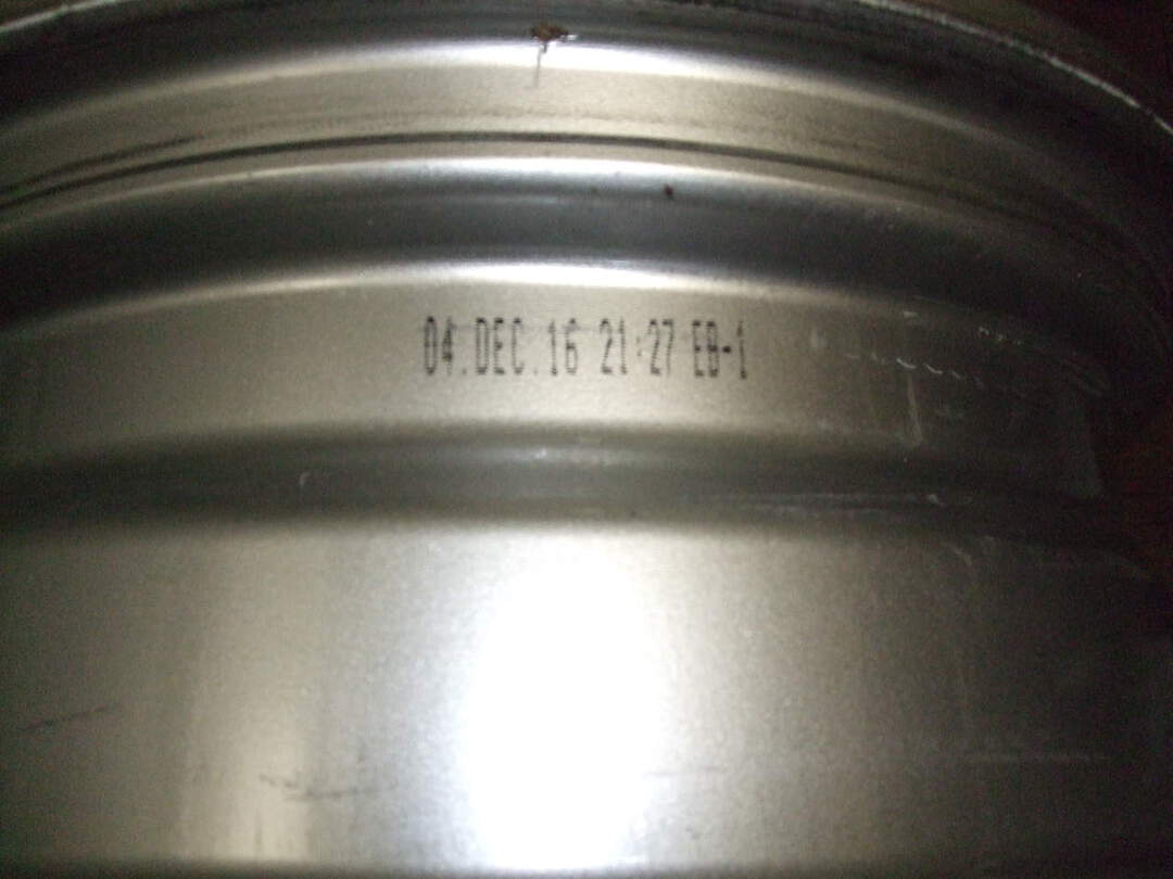

date manafactured 04 dec 16 21 27 EB-1

but most likely fake because there's no 6 1/2 jj for RPF1 in 15" size. the offset only came in +35 and +41 for 15" in 7jj trim.

You mentioned engraved, but most rims are embossed, means molded together with the wordings. Engraved is to cut it.
The wording, is it "Japan" or "Made in Japan". Japan only means made elsewhere but Japan Brand.

in the picture it says japan only . now i know the differences of engraved to embosed lol:idea:

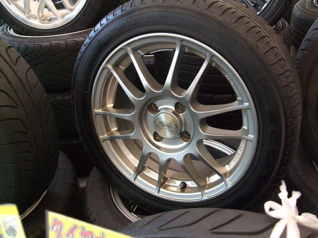

Bro, the design already is a clear cut clue for you.
It's not even close to RPF1 design.
---------- Post added at 02:18 PM ---------- 6 hour anti-bump limit - Previous post was at 02:16 PM ----------
Your picture ...
RPF1
See how the spokes are integrated into the rims.
Spokes are also different.
