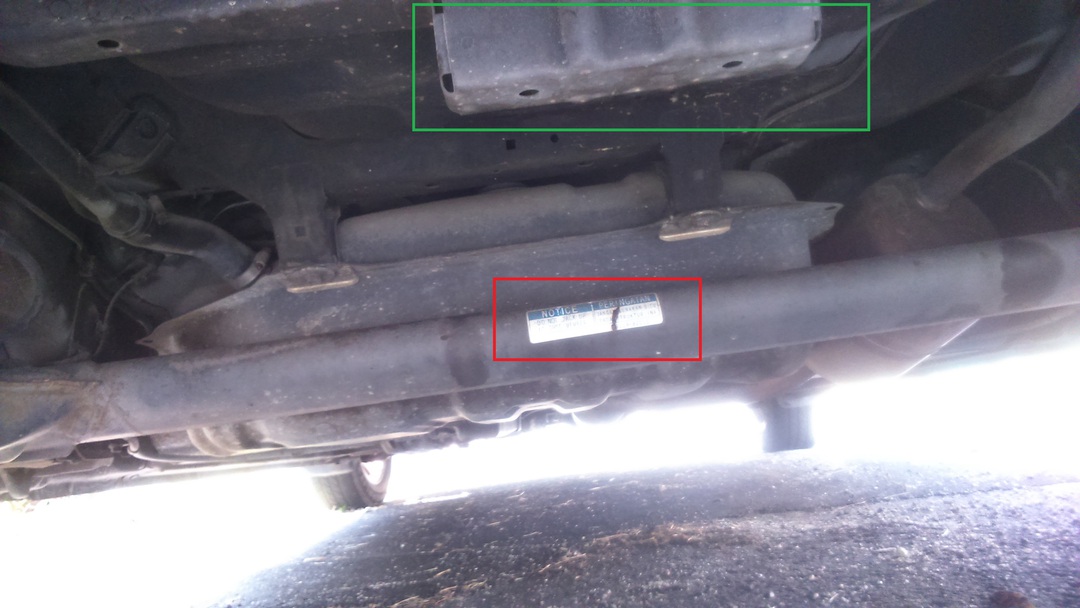

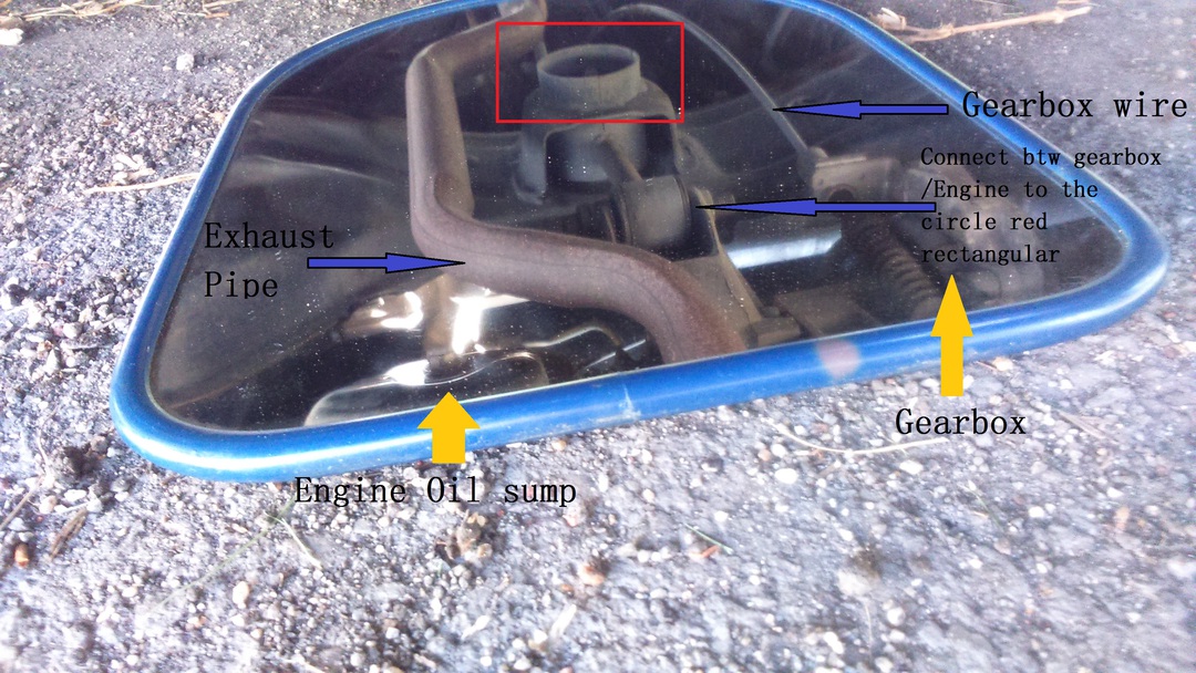

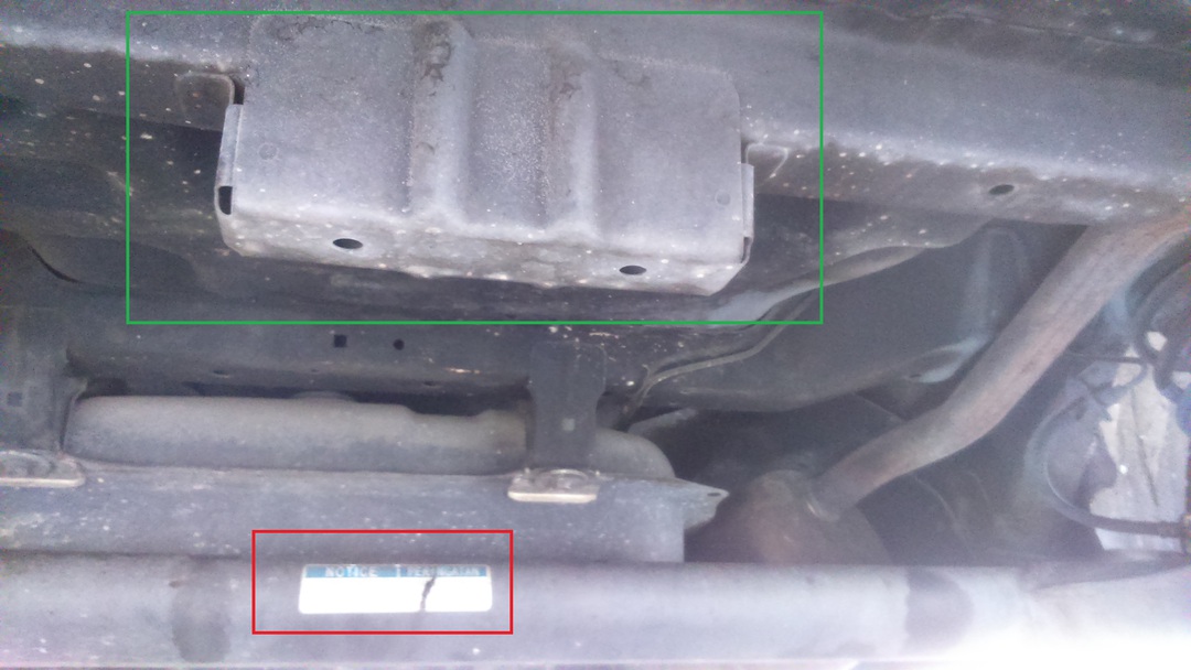

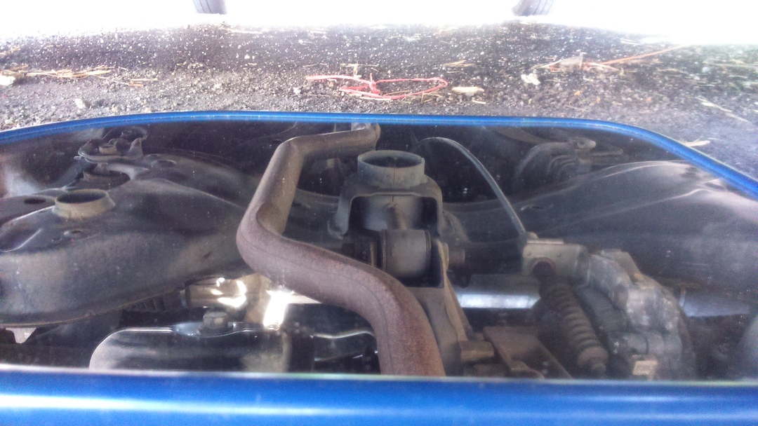

Izso I just use mirror to took some pictures of the Myvi underneath. (I know it need imagination to understand my picture location since it is a bit hard to take photos of it).
1. First question is can I use hydraulic floor jack to jack on the picture red rectangular part at the center, so after jacking up I can easily to two jack stands at the weld pinch jack point. I not sure what is it, maybe is mounting for engine or gearbox?
2. Second question is for the rear part. should we jack on the green rectangular part shown in the picture? Since there is a sticker at the torsion bar (Red rectangular), we cannot jack it , the green part just before the torsion bar I see is quite solid at attached to the frame, seem like a perfect jack point for rear center part.

1. Don't jack up the car using the engine mount! You just need to find a point under the car that's solid, not moving and preferably stiff.
2. I am not comfortable with that spot you highlighted. I need to go back and have a look at my car to double check where I jack for the back.
What sort of jack are you using? I'm using the mechanic type 3 ton jack. If you're using the jack tat comes with the car use this mounting point but be warned using jackstands here will spoit the "skirt" :

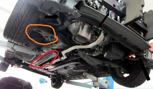

For me, where I put my jackstands is here (the red box, ignore the yellow) :
I know the pic above isn't a Myvi and is the rear of a Hyundai but the concept is the same. The jackstands hold up the car at the point where the arm meets the chassis and it's the same for the front. Personally I think this spot is pretty strong and is more than capable of holding up the cars full weight.
This is my actual car and pic, the jackstand is just about where I am talking about earlier.
