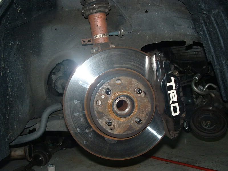

fuiyoo TRD 4 pot tuu.....
More like Skyline R32's 4 pot painted black with TRD sticker, bro:listen:
