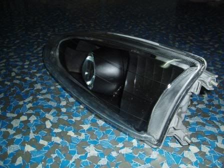

DIY: Retrofit Projector lens into wira headlight

For the step you can search for the previous post.
There are photos attached.
For the cost, it's about RM350 for the done unit without the D2S HID Kit loh.
RM350 is for a pair of the e46 bosch projector and the wira headlight only.

does this bosch e46 projector for right hand driver or left hand driver or you just swap them around ?????
hhh
Aug 19, 2004
134
1
3,018
Penang
It has right hand drive type and left hand drive type.
In malaysia, we are using right hand drive type.
But this projector can just turn the shield to suit our like.
Thanks.
