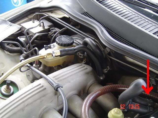

the other sound is not really a damage..just have to bypass one of the hoses..u can ask rinagi...he's done it already.
Rinagi, it's good if you can indicate / illustrate which hose...
do the same as shown. make sure after u bypass, u clean the holes with water.. pressure it until all those rust come out. BEWARE !!! HOT
