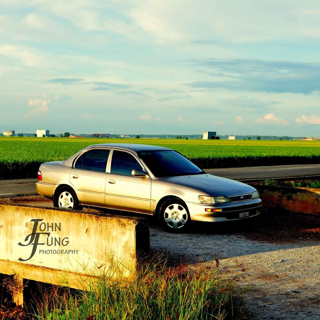

Hi all the sifu and tai kor here.. problem so far now subsided with oil change to thicker oil..
Share a photo here of my car for you all to see.. I do photography for a hobby/part-time so anyone wants to do photo shoot can la invite.
