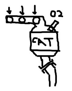

this is how de stock extractor look like... de 3 arrows is de lubang la.. n dat is my CAT n o2... n i didnt replace anything after i tookout de CAT..
thteh.. yeah.. i tot of dat also.. but duno whether correct anot la..
