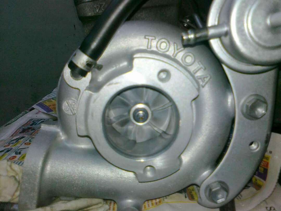

steel shaft+60trim wheel!!!done by Speed Spin Turbo Service
