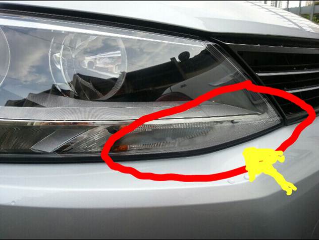

I would like to find out in general whether vapor in head lamps is common?
Cause I just bought a car and when it rained vapor built up inside the head lamp.
I would like to see whether anyone else has experienced this
