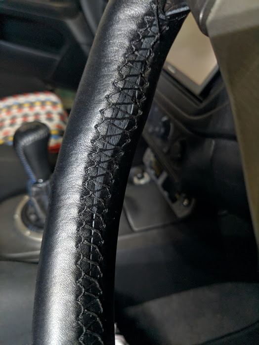

this is the one i tolong orang buat, you got to make sure its tight
Screen Shot 2021-02-09 at 10.46.22 AM.pngScreen Shot 2021-02-09 at 10.43.59 AM.png
since this was done to protect the wheel, at any areas where the thread might touch the wheel, i added a piece of cloth underneath (i feared the string might leave marks on the wheel)

not in my case as mine is made specific for waja. I had to glue at certain area especially the bottom spoke just like the ori. universal type just cover the wheel.if u check again the pic i posted, the material cover the spoke until the steering button for left and right spoke and under the horn/airbag for bottom spoke. Need to use dunlop glue here just like original cover.
oh ok, so the replacement cover ends up as a permanent cover
