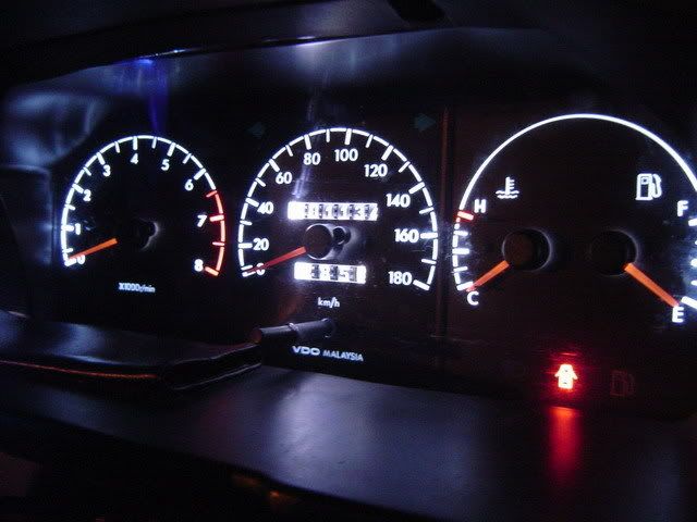

nice or not??...
Nicely done Skywalker.. Mind asking what LEDs are you using. Haven't really taken out my dashboard's meter to see what bulb is the meter using. Is it t5, t10 . Does it necessary needs the rare t4.2?
SkYwAlKeR
Over 10,000 RPM!
Mar 12, 2005
10,139
300
5,183
ePoh ~ malacca
Visit site
so freaking bright man!!!

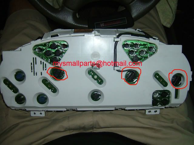

newbie ya ... using mivec dashboard with 4g92 meter manual now is yellow wish colour i wanted to change to blue can tell me wat size and how much is the bulb ??
and wat do i need to do step by step pls T.T..... and do i need to take out the meter needle ??

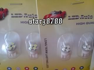

hi need help
dismantle out the meter 1st
check using t5 or t10 bulb~
rear view meter picture got circle is the bulb need to change..
bulb size
t5 and t10

also, test before putting it back. LED have +ve and -ve (positive n negative) so if any section of your meter cluster is dark, just flip over the LED and test again.
