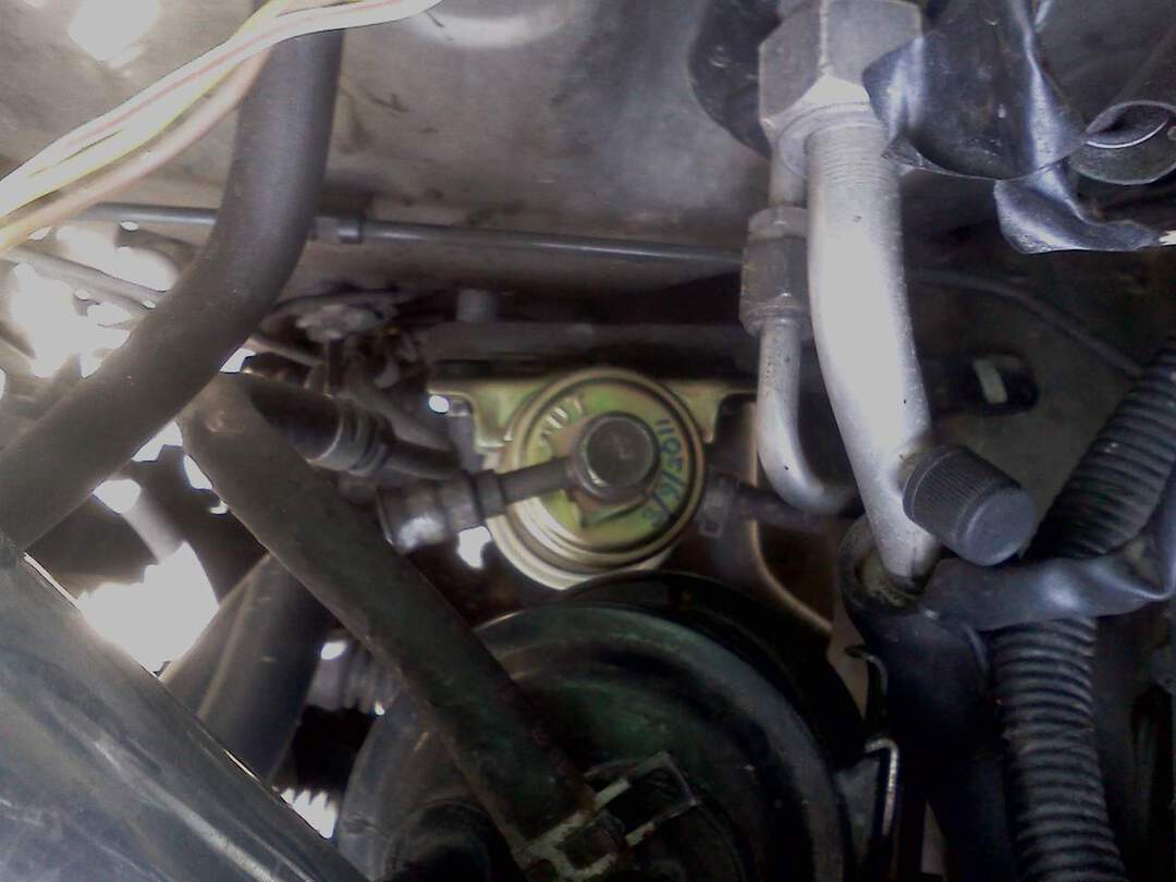

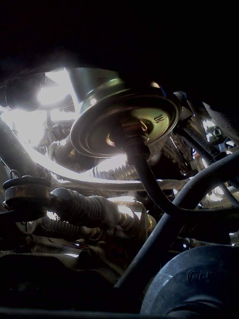

Hi all, just wanna share how to replace a fuel filter on AE111 4AGE engine. I think AE101, AE92 and 4AFE engine would be the same.
p/s: The pictures I took is reverse order (installation process to remove process). But I tried to explain it in removing order.
1-Remove fuel hose at bottom of the fuel filter. 14mm nut
2-Remove fuel filter holder at the side of the body. 10mm nut
3-Remove fuel hose at top of the filter. 17mm nut

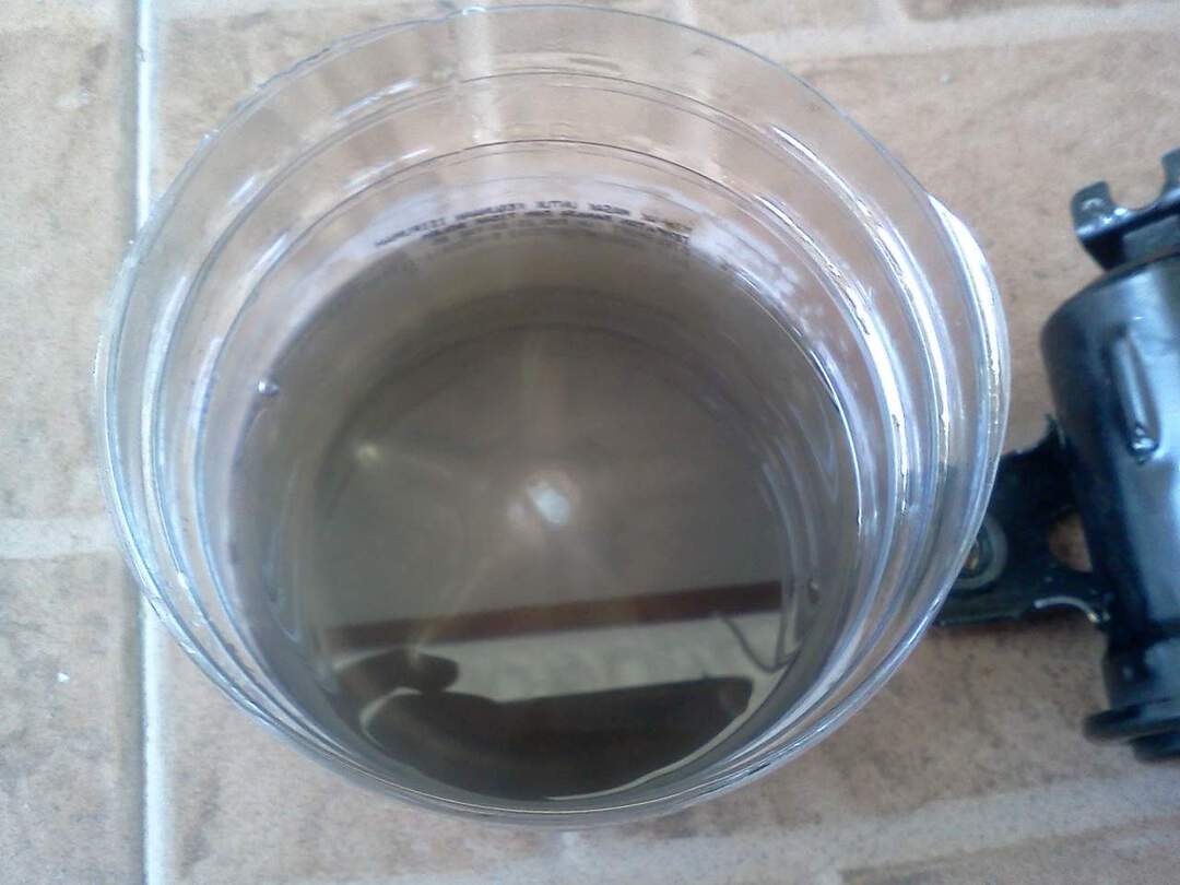

4-As we can see here yellow Ron95 petrol has turn to black and maybe clogged injector too.
5-New fuel filter on the left.
6-New filter on the right.
After change to new fuel filter, my butt can feel my car more responsive.

Nola bro, this black petrol was poured out from the old fuel filter of his car.
