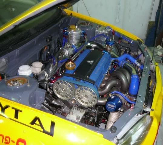

aiseh, i dun like the look of evo3 engine ler, looks so old ade..sorry, i dun mean to insult those using evo3 engines but i really like the new 4G63T looks(E4-E9)..i like the red color valve head head with the timing belt terbalik+valve cover....just love it so much..but i've seen 1 SGTI with EVO4 for sale at motor trader and he says he's got JPJ approved..there was also a Putra EVO4 for sale here at ZTH and it has got JPJ endorsed as well..so i'm kinda curious lo..
can fit tis da pic fit on satria body :smokin:BUT alot of job & money involved

yaya..this is nice but i think dis is a drag machine right?..
