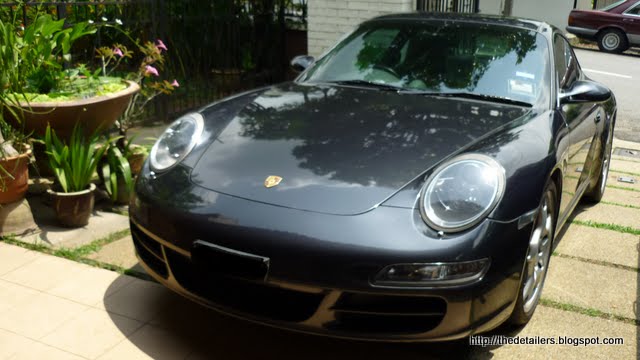

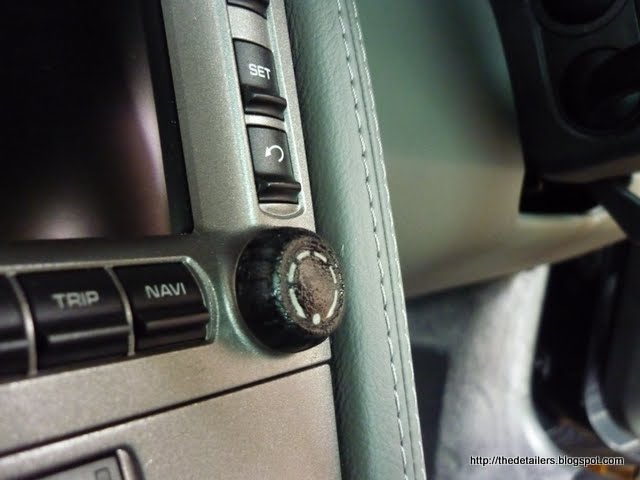

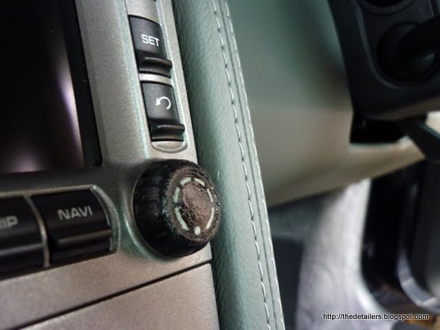

I had this wonderful opportunity to be able to help my buddy to beautify his interior....but there is TIME & COST effective ...limitation issue... he needed the ride in less than an hour.....

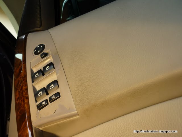

most commonly problem for any germans ride.....my bud thought Malaysia is too hot...so hot till the knobs in his ride melted....as you dont find in any other ...as they are not rubberished
common know issue in other German Marque Machine too....esp in E60s

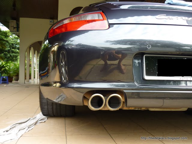

1. wash & dry within 15 minutes - ONR No rinse wash
2, wax within 10 minutes - Optimum Car wax (spray, wipe & walk away)

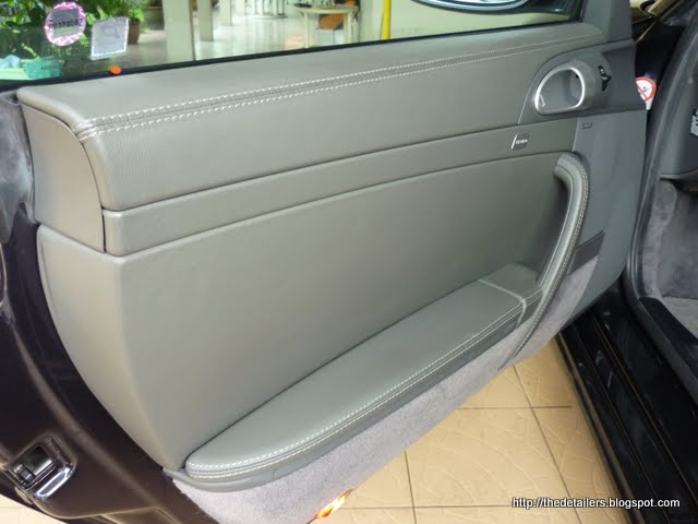

*dash & seats quick wipe down with a damp Microfibers 10 minutes (highly recommended weekly)

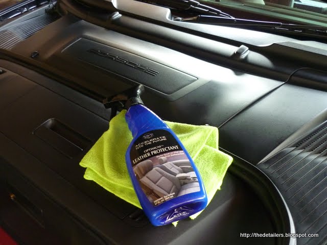

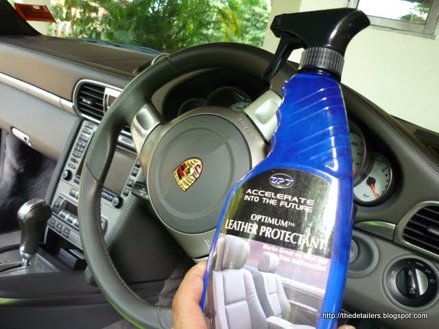

*leather & interior protected by Leather protectant plus (another spray, wipe & walk away) is good for all interior plastic, vinyl & rubber - 10 minutes

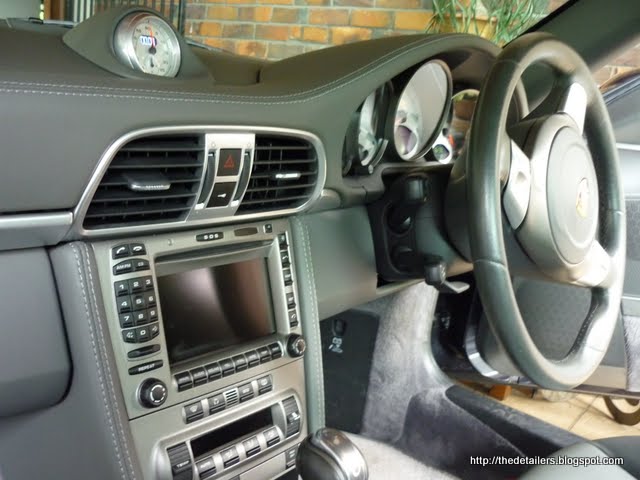

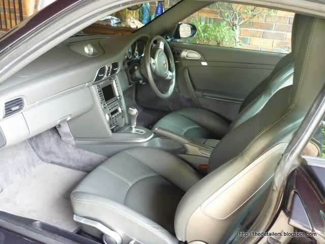

ta da to here

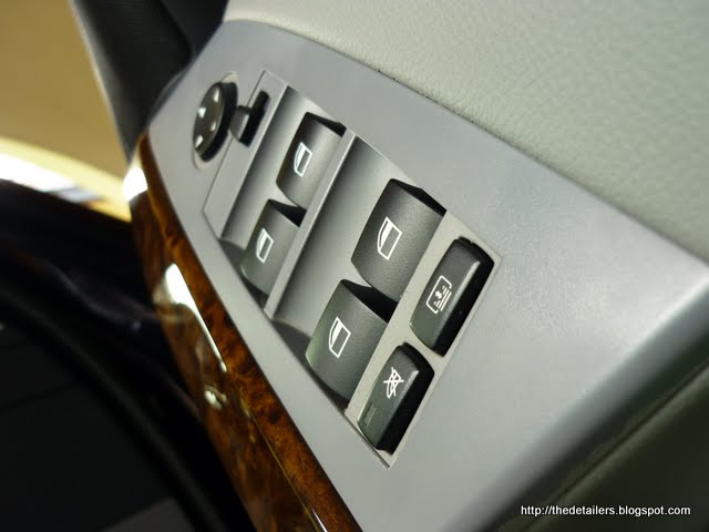

remember before
By cleaning with Power clean & microfibers

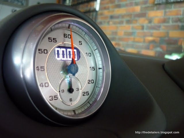

a special techo time...speciial edition comes with PSM .. Porsche Stability Management serving to intervene in the engine management and brake system in order to stabilise the car in both longitudinal and lateral direction whenever the car is driven to - or beyond - the extreme.

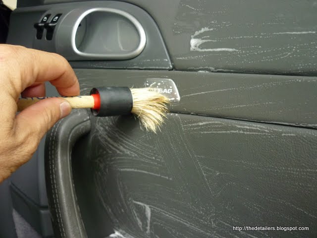

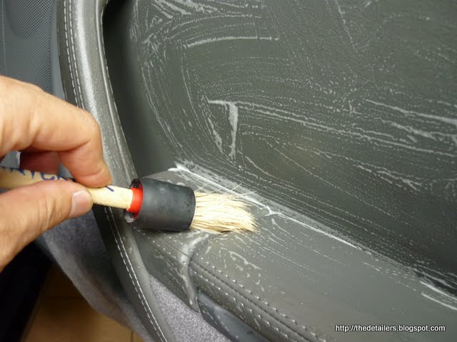

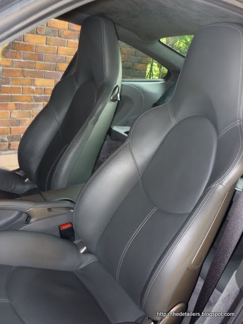

Leather cleaning....
recommended soft hair bristle brushes
ta da

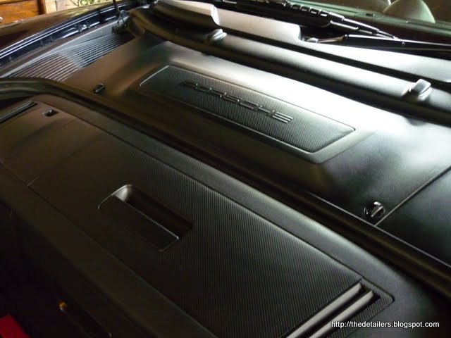

now the dressing time

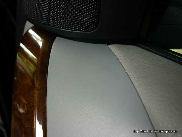

(a spray on , wipe off & walk away) is good for all interior plastic, vinyl & rubber

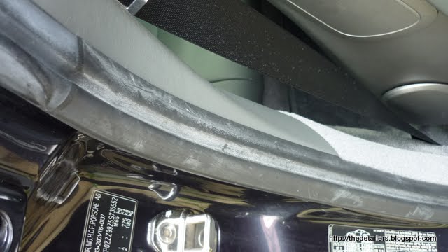

many door jams rubber faces the dull looking & whitish powdered finish
a dull looking interior....unattractive vinyl
picture before
ta da

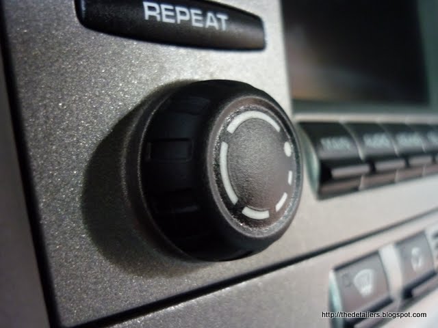

just a soft touch
another breakthrough invention...leather, vinyl , plastic
now this is the most optimised looking vinyl & protected against UV & the heat of the tropics

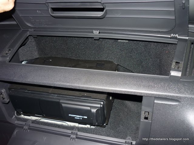

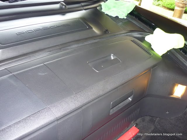

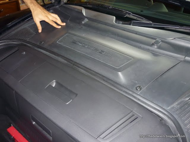

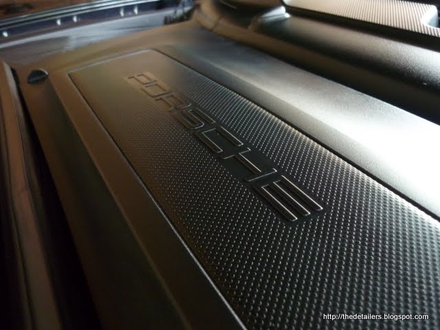

another hidden compartment in the trunk
before
a well detail trunk & the secret chambers

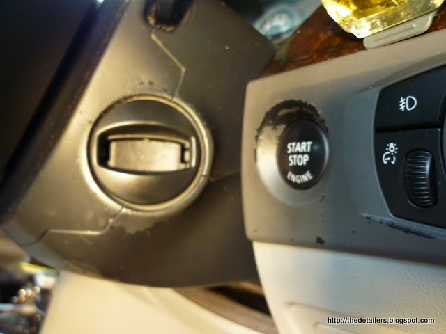

1) for the chipped/worned out push start button - was there a remedy or is a respray needed?
we need to gauge the area size...if it is just a knob or smaller area...it is easy to tackle
as shown here...which i am about to show u in an extreme make over of another E60
as for the bigger area....it is another area you would consider careful prior touch, eg we did a S class centre console ....detailing....we literaly derubberished it....took us about 2 hours...nicely finish..
now peeling issue is so common in all german marque machines
now common issue....rubberished parts peeling
ta da finishing picture

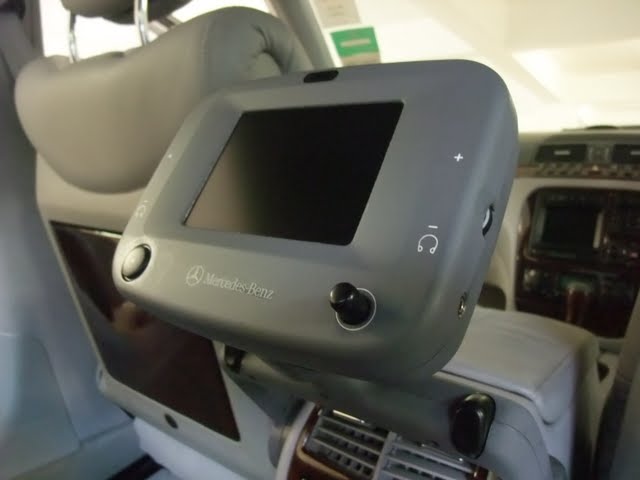

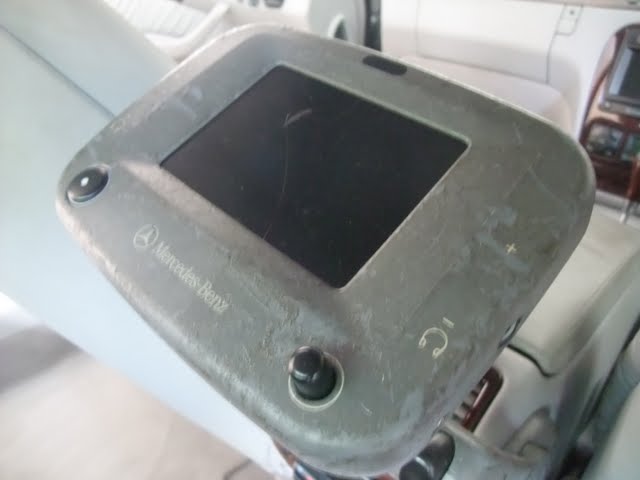

The rear control panel was also a real mess. The soft touch rubber coating had melted in the sweltering Malaysian weather and the panel was sticky to touch and looked terrible.
