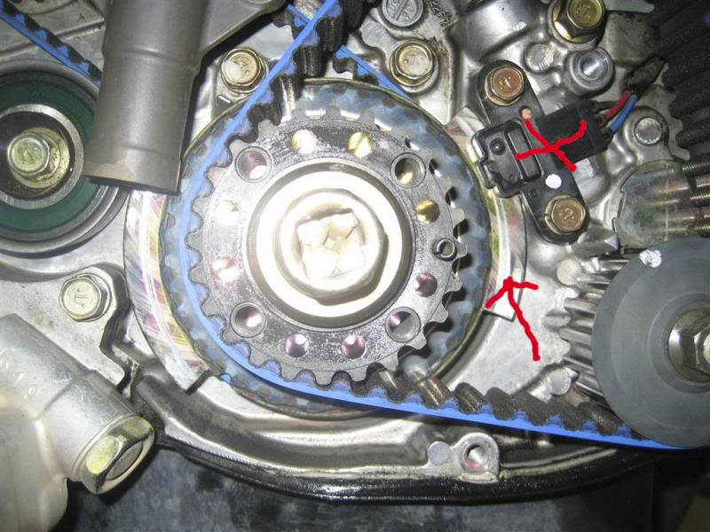

Outside means it isnt protected from the environment. Next is a picture of crank sensor for 4g63

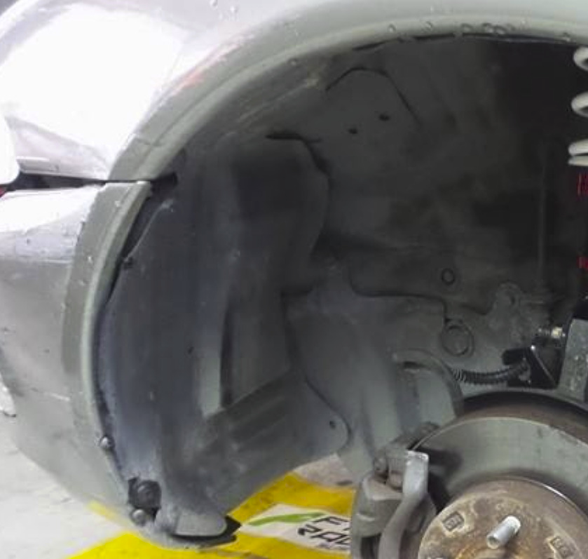

Yes,the crank sensor didn't protect by anything. And another I found out is the car left bottom engine undercover is gone. The right one still have. Is like I turn my steering to left I can direct see my crank pulley & sensor already.
That's another reason I wanna find a engine bottom for it.

i had one. From Orsen but they are in KL. Their covers are pretty solid and have plenty of ventilation for airflow plus a lot of removable hatches to access filter and whatever. But like stupidcar said - you'll need to monitor leaks more diligently because you won't see the leak until it gets blown over and out of the cover.
the side you want to cover is the driver side. If I recall correctly the crank pulley is on the driver side and that's the part you want to protect.

not the passenger side ah? coz iinm gearbox is on the driver side.
No need debate. Which side did you take the earlier photo from? Your crankpulley is visible there. Should be passenger side unless you have one of those terbalik engines.
