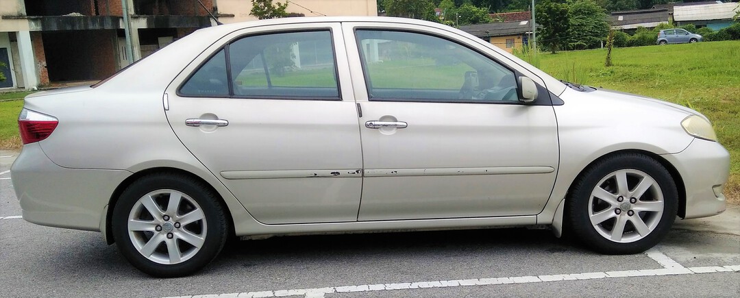

before
_I_miyAfPAfLFkhvq1f-CwdrfIteQHZ9YmN-n5HMvcehSOz472oVZ-3idLg0Pji3HLunkTOXQ1y_ifVquu-DH8MAMsKLqsuB1CDlQpUTaGIePSu9rQskx5W9nWrcn9r59mPCVuJHVVbEG6RZZRAM3162Tr3rE_uqocsdMTIub-KlIsW0z90em2kXdsJnlqy_DQVxNKFGFhsMCEJ3ZV_sM2UN15mkNMjgAXTsQmehfb3mOOwt0tasqOP7vjAV0rJBX4sY_hLEKdV8IC2P-99EXNFKlWzlvKqxM9ZfA_w-hO6C4fu64ExNL6Qz64-2Vsdz5G62dlivISEF1im_UF1Za9IAgmtdtehpWHWuO5qk78M9VLo7mCs3PJV47mxQ5sg3BFs3EIplmco_atU9evPopKH84SIfqd454zuPyxNkTZ8zfV7nV142exkiEnh02Fvrl0dTG0ewF-5etM9VpDt3923zmcZP-fo26GI_Hntb0H9lfe9Q_sk-jAaFBV5zbdiKxvT-I1zqHxvq4YuxP-VOTDazF3zSzjS99CHRNArL1ff0Bi1ReXCfHj0Z0yHKe05gs_BZWJBKptspbouBup_njpBdtHbDq0x9knyIW0rjtpcemMPCp3G24WvyXcwEeDhit71sf4AmOY1kbT9YvDZNH9RN=w341-h605-no
after
MoxCBzbz6tzKTVUDdY_04K4aKtC80WoVXV7ysvI-oWBzse2r6LM__tbsuDQk4mR04ZqdTiUddf-I8rUVDCJPOInPsqMNf3Jris9ScsvWw9C2c3kzqI9G2P0rD5UhVocl-nQJOfjo9vbShk_s5Ga4ORLWelEX3B9jbHMLuOuLnfAplBFIo3weu3boGIU8AmCGYCUglOWUPlXPvbyUKPFG4o4EsriAnQiJkl2dd72VMBmnrZmj-jbQUDAUqJPRtL9LcnAyhruRcPcIGeU3U17n2qppglNFDflitO1NFNedqHdfKJBGO9p51igopETlHRYBTw4zpPqXasvSSTHlwGxyGG98shj2kIBmMhZlz0cWcFUMydZ0OSu8CI__zN1uxDP3Uv2cIYFkEo6GtW49eMFPXBpIy0wFOMzZQ_H_9COzcZ7WUg5ukjKg3xP5QcBrs3LKD059fXMvepTzQkjVvD0_ltfknFE9EDZ46N147DOWSvMxHXm02jKgV9GTD-Kk7OYHf7nrzSI2qT_OaMsXFrFZYKzbrU6NYfSisYaT_RDUoXQujK7tLUiLagPu8jkEkcVejS8SJGUde_0KCRBDjqzIfsU74Mp9VJ-j1ovdf8kXis3CEr4uUucjNhpzmUCwrjjuFfVajOGTXXqKZxVYCmCNfD-n=w341-h605-no
If overall is too low, looks like changing back to original stock height suspension will be best.......
agreed but will keep this setup at the moment.
no worries, i have a SUV which i seldom use.
i prefer the vios because its so easy.
Your before and after looks exactly the same :biggrin:
mana ada. BEFORE it was lowered, the bumper was above the tumbler.
AFTER, the tumbler cant even fit under the bumper.
Wow, that's several inches of drop

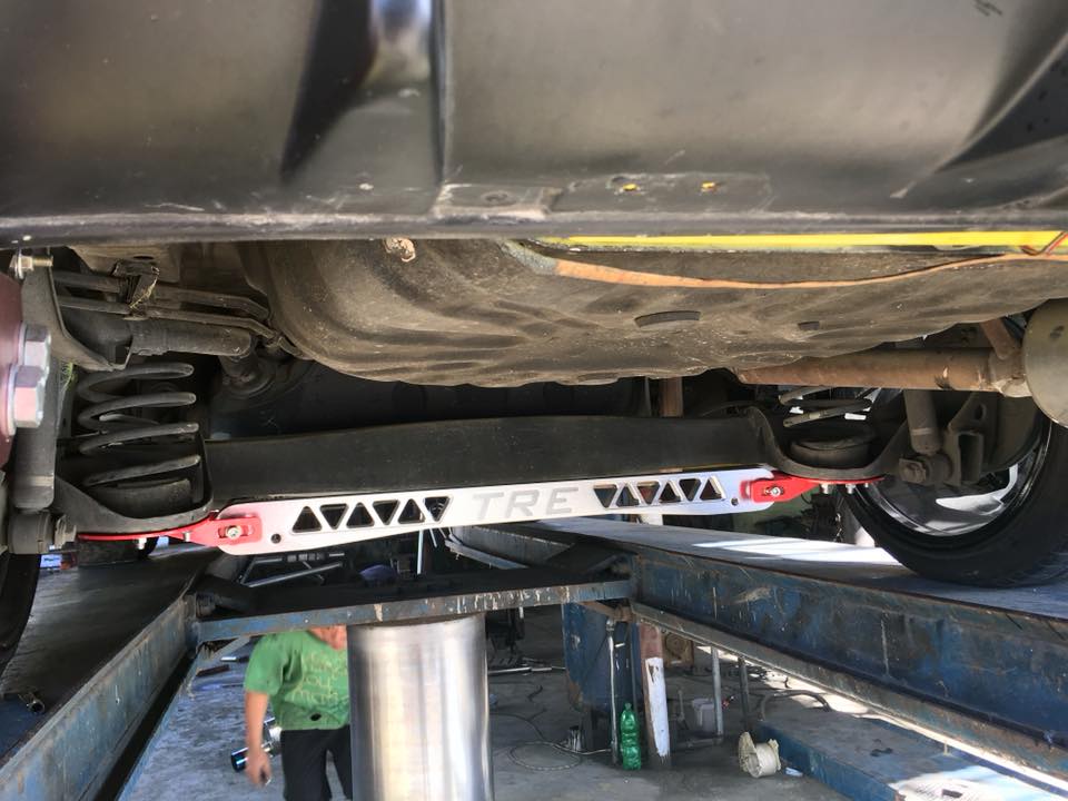

this is hows it looks like now. my initial paint job budget went to replace the suspension system.
paint job can wait.

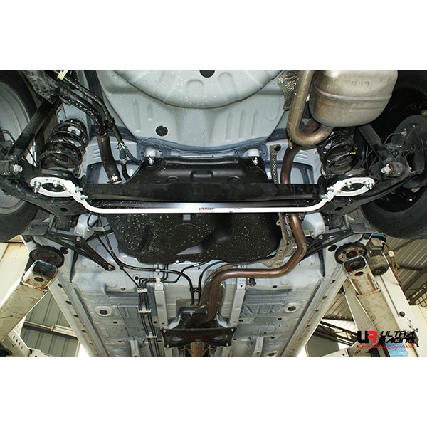

looking into strut bar and rear subrame.
not sure if the rear subframe a gimmick but the Anti roll bar is hella expensive.
paint job can wait.
get the antirollbar FIRST!
strut bar and subframe bracing doesnt do much if to be honest....
ARB is more expensive due to its function
