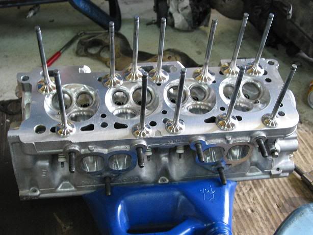

Below is an example or ported head, from my own engine :

My PnP engine head requires 2 week to complete, it's done at Powerzone. It gave 7% horsepower increase on dyno.
