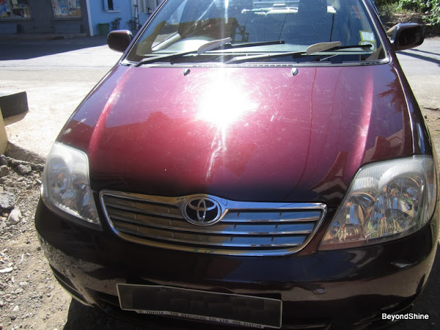

Here is an update on the paintwork, not yet posted getting a very bad wrist pain (RSI syndrome).
It’s not a full correction though as the car is going to be sold.
I had to move to my in-laws’ place to carry out the buffing, it was too rainy at my place
The best light was amongst us, thanks God! So, let’s see how sweet paint was, I mean swirled!
Close-up
Extreme close-up
The roof
The vertical panels
Remember from where we left, cool car!
Looks are deceiving very often! :bawling: The reality is different.
Every section was more or less the same, added to the numerous RIDS (the paint is a soft one too). The ride is full of decals so I attacked the most obvious areas: the hood, the front wings and bumper. The rest of the car got a coat of glaze.

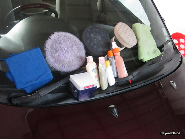

Products used:
Some towels
Pads: LC wool, white and black
Polish: Uber Clay, Menz 203s. Megs #80, Menz PG, Menz PO85rd, Optimum ONR
Looks can be deceiving! Beware! The Johnson bottles are just my dispensers :rofl:

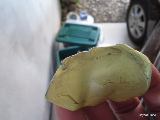

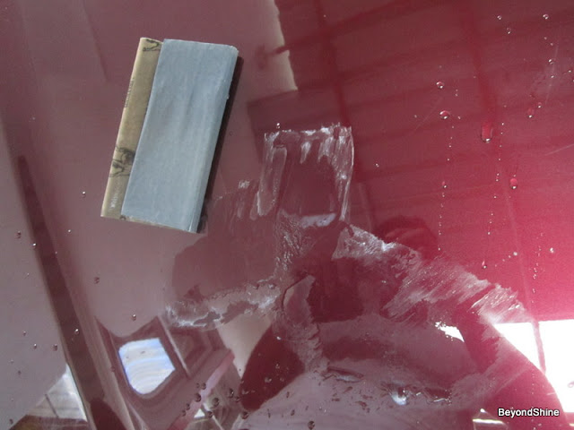

Rinse & Clay

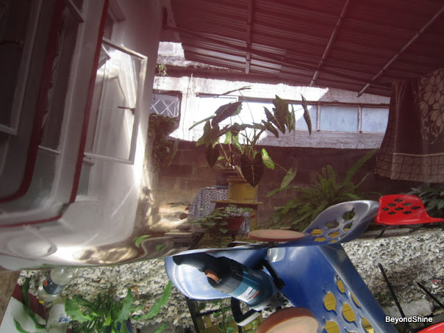

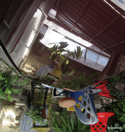

Buffing the usual way,
Compounding: Menz PG S34A, LC wool pad + Makita (Used M#80 to lubricate the pad) It works for me, but pad need cleaning on the fly after each section.

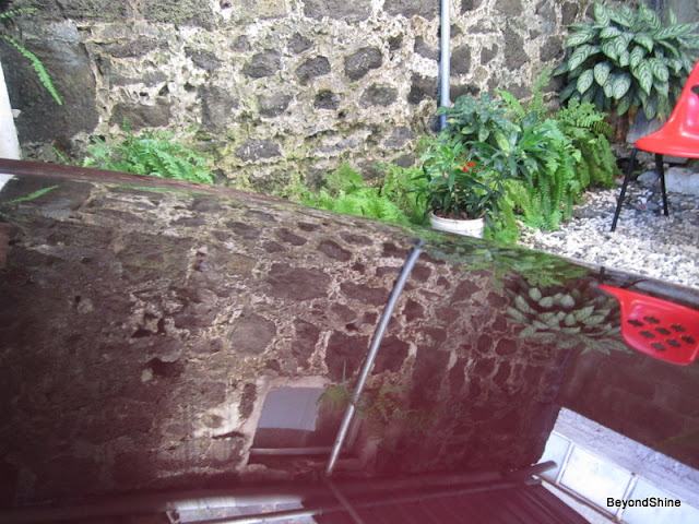

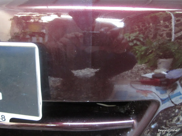

RIDS became apparent
Wet-sanded 2000 grit,
Buffed again with Menz 203s, LC white + Makita (Flex for the bumper). RIDS are gone, clarity and depth improved.
I refined with Menz PO85rd, Flex/Makita. Stone chips were visible, in fact the very first thing that others would see, but out of focus for me, due to the depth and gloss restored, (:listen: I’ve been seeing only swirls and scratches)

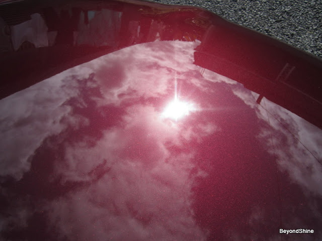

Some 50/50
Some sun shots
Sun was shy
