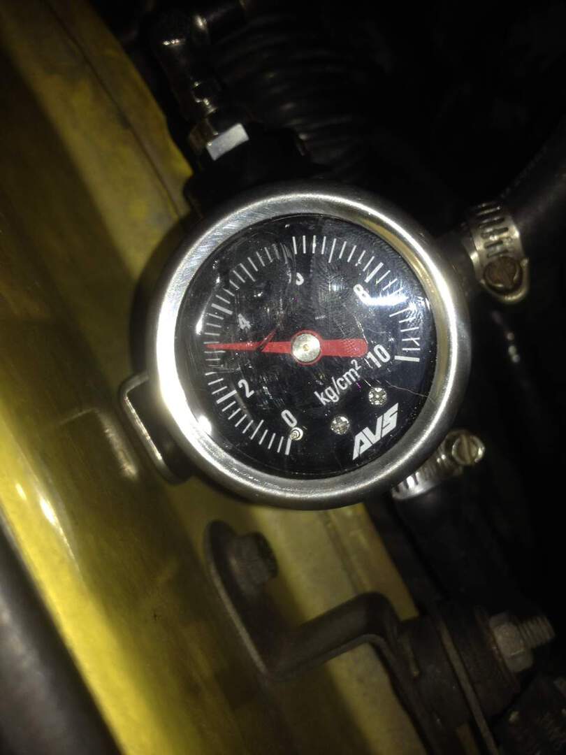

no worries bro, previously i thought the same as you but the problem is i couldn't source any stock regulator from the spare part shops i know of, which include an authorized proton dealer. that led me to 2 choices, either a used one from chop shop or, a new FPR by a trusted brand. i went for the latter, cams and injectors are stock. reason why it was already fitted with FPR is cos the previous car owner ran this on a piggyback so he had some extra toys thrown on. hope that answers your question. :shakehands:

hmmm.. got any photo of the FPR ah?
i'll snap a shot when i get to my car later :burnout:

sorry, i didnt make myself clear last time. i wanted to see the whole installation from the fuel rails, hose type, connection and all. haha. but i guess everything is installed correctly then. :biggrin:
UPDATE: i just made sure the FPR is fitted, hoses trimmed and screwed on properly. the mechanic who installed it didn't tighten down one of the nut..
:smokin:
started the car and the dial up noise is no more! (DIY FTW) problem now is i can't seem to get an exact 3.2 adjustment, every time i lock the bigger nut it'd go slightly off :mad: will drive it later, observe and update.
really thanks for pointing out :beer:

back from test driving, quiet initially but the dial up noise came back later on :banghead:
probably a defected FPR, gonna ask for warranty replacement. getting the alternator and compressor checked by AC guy tomorrow.

UPDATES on AC/Idling problem: had my alternator charge rate checked, normal. AC compressor is the correct spec (15C) so that factor is eliminated too. the foreman tested a few spots, made sure the AC system is working fine and suggested it could be the throttle body (back to square one). this isn't his forte so he said best i look for friends who have similar rides to troubleshoot.
called this mechanic in sri kembangan, got my car fixed there once and he is one enthusiastic guy who's crazy over 4G engines, owns a mivec too. anyways, he said the problem could only be around the throttle body area. confirmed by few mechanics already, glad that its narrowed down to that area now :proud: will get it resolved soon. at the same time, jaring is still dialing up in my car :stupid:
