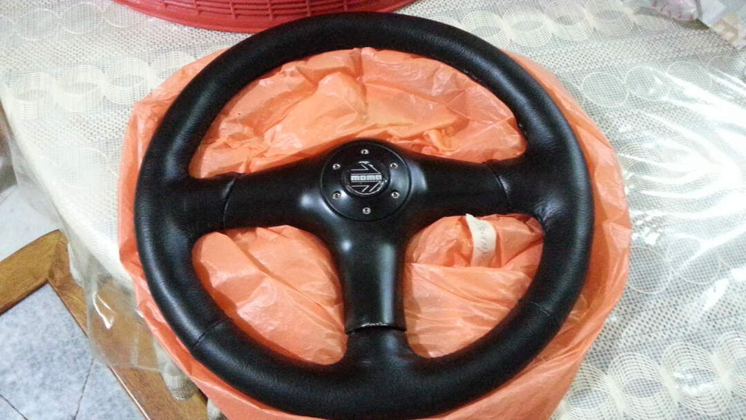

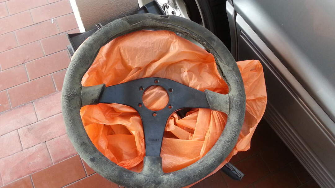

Where you go wrap this steering? or you DIY?:rolleyes:
These sort of wrap was popular last time. Had to search many shops before I found it. Wrapped myself. Quite easy.
I like thicker steering. The feel is good. Very good grip :top:
Hey, if you do manage to find this wrap, let me know where. Want to keep spare

standard size. Not sure the size. Currently using aftermarket 350mm. Just nice.
Mod not much on that subaru steering. Clock spring cable connection only.
I still modify the clock spring connector for hub and aftermarket steering.
Wah. You install clock spring ah?
mine is a 350mm Momo, perfect fit :driver:
Nice laa got MOMO
