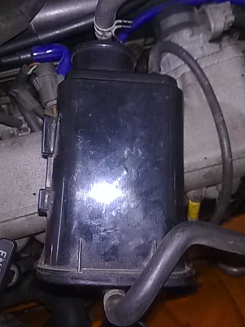

Hi to all..
confuse here:hmmmm:..can anyone help me..my mechanic dun know how to connect the item in pict cause he forget after dismantle it from halfcut..my halfcut 1JZ Gt jza 70 supra..
top pipe go to where?and bottom pipe go to where..
thanks...

Thats the EVAP canister, for emission purpose only. Bottom pipe is vented to air via 1 way valve. top pipes should have 2 , 1 to tank and the other to fuel rail. alternately get rid of it .... like i did on mine...:)

there is one vacumn pipe connect to inlet manifol..so if i dont want to use the tank so just plug the pipe?
