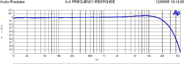

one question why are test lab using analogue system testing method which is cater for conventional alalogue amp like class A and Class AB to test a digital amp like class d which is a digital amp?
brother... class D isn't really a "digital amp"
here's the line of ICE...
Analog/conventional...
inside HU
CD/MP3(digital)==>processor(digital to analog)==>pre out/spk out(analog)
then normal amp class A,B,AB, or D
pre in(analog)==>amp (either A,B,AB, or D or mixed class config)==>speakers
Digital
inside HU
CD/MP3(digital)==>processor(digital to digital)==>digital/optical out(digital)
then Digital Amp
digital in ==> Processor(decode digital to analog) ==> amp (either A,B,AB, or D or mixed class config)==>speakers
Thats y you'll get "Digital class D" amp or just "Class D amp" or any other class in the market
As for the benchmarks for quality... there are "sound engineers" where by the give marks for what type of quality sounds they're testing. They still use ears :biggrin:
Thats a way.... another, is the "Frequency response" bandwidth where a device will show bandwidth graph dB vs Hz/kHz to judge the amp/HU responds...(too scientific oredy)
eg. (see below)
you may find this graph in some of your amp system... it's nomally attached with your instructions/specs/printed at ur amp.
