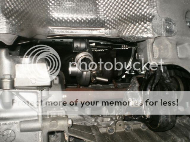

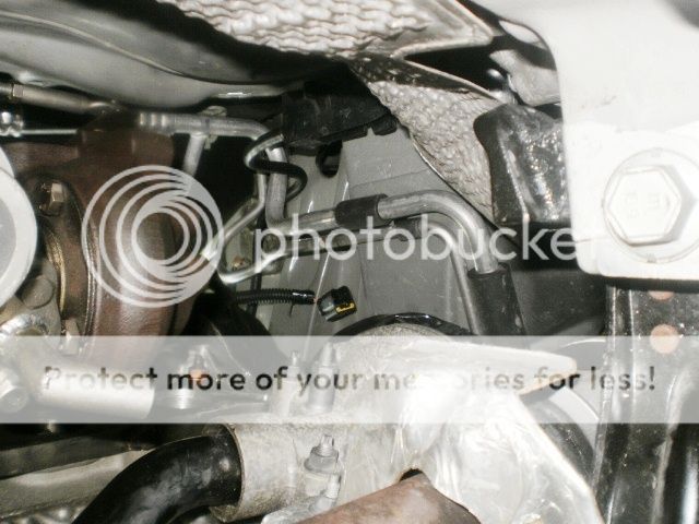

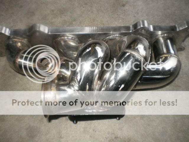

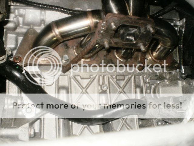

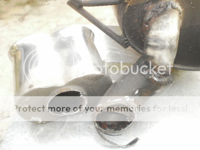

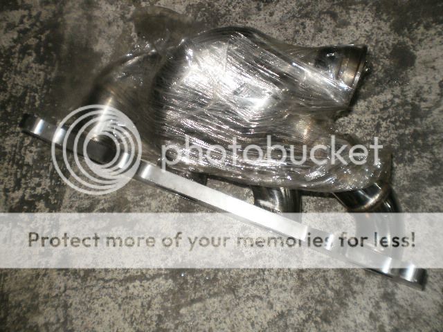

'BOT' PEUGEOT 407-some work end of last year....

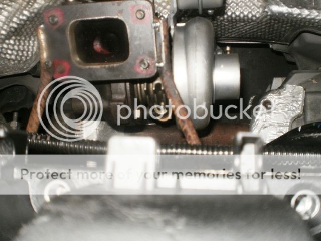

Start with fitting turbo....try from upper,,,bruuuutttt,,,
All about clearance...

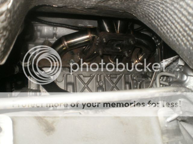

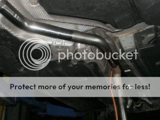

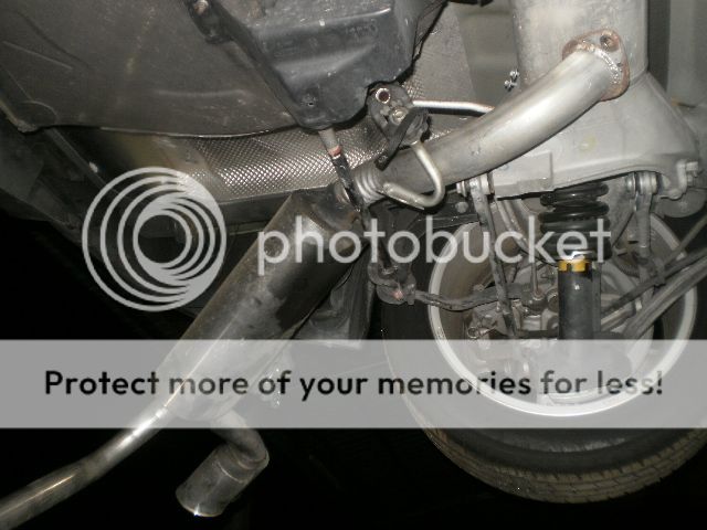

Exs that come with this 407...Fast work,fast money....
Try to take out...buttt....
End of the way..

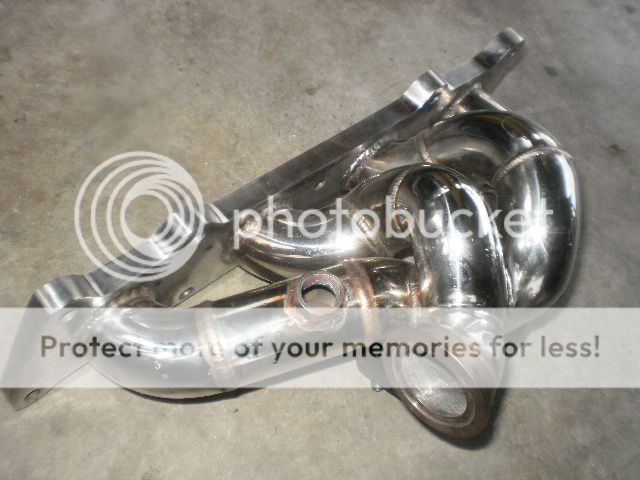

Now start with new exs...

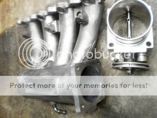

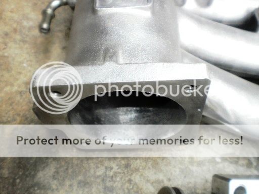

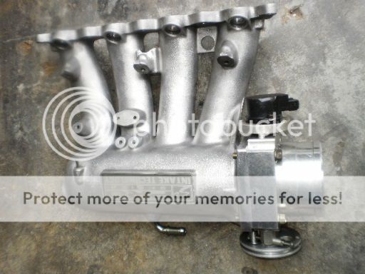

B-Series IM to 4G 93T
Another meow Sk 2 IM mode flange,port match...with 70mm TB...
After all work done,finish with casting surface looks..

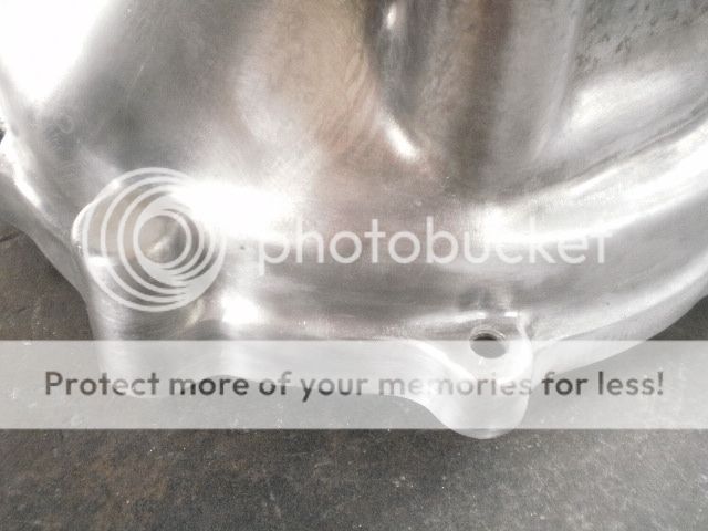

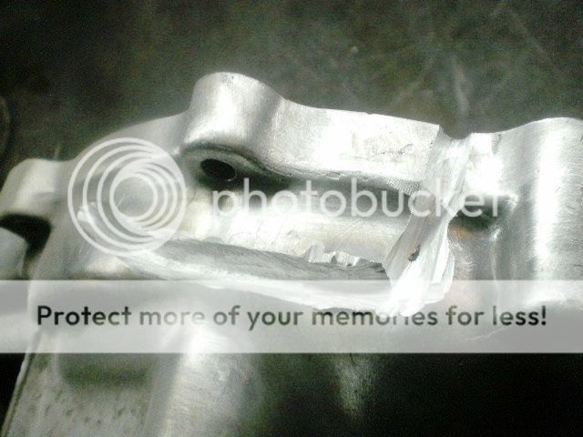

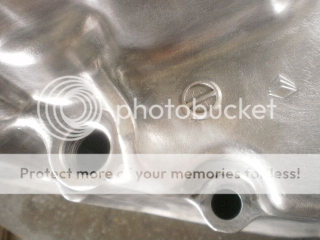

GEAR BOX CRACK REPAIR
Grind a grove to dip more filler rod when weld job
First pass weld
Second pass weld-Blended
BEFORE-
AFTER- Grind,buff and sanding work
Before-
After-
Inside Weld-

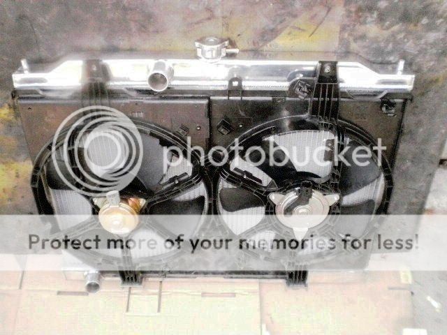

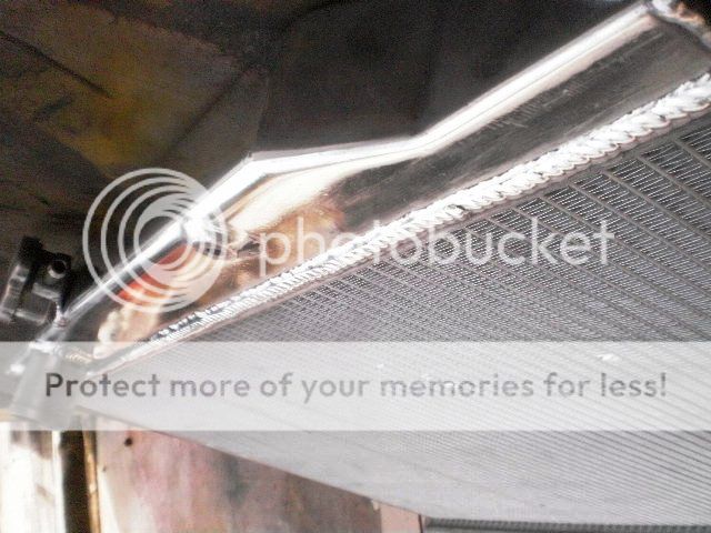

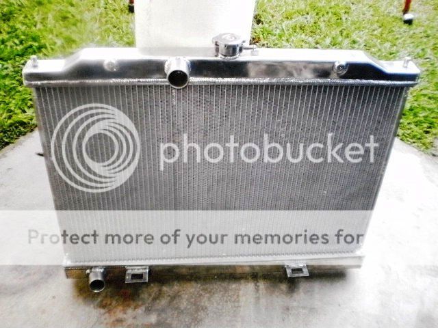

FABRICATION WORK..3mm Alum. END TANK - 2 LAYER RAD. CORE
FOR NISSAN SARENA
DOUBLE PASS WELD END TANK-
