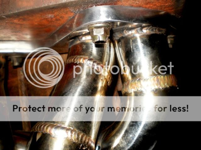

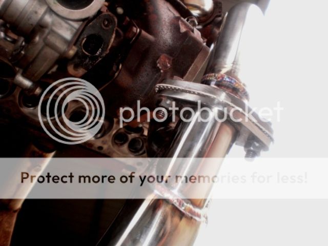

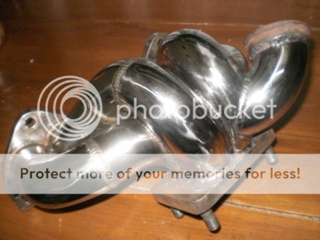

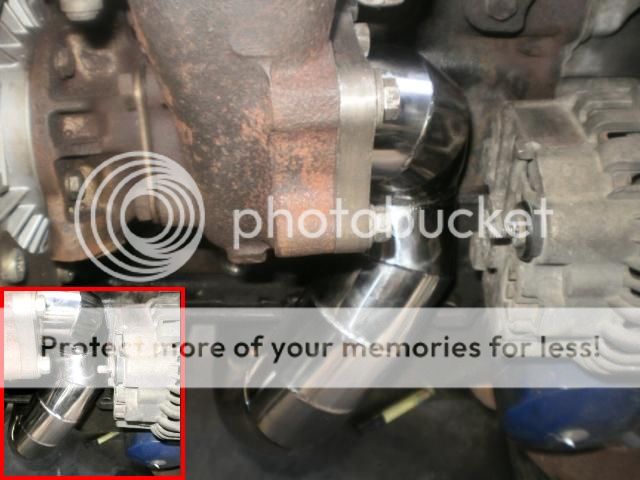

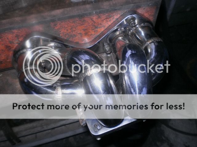

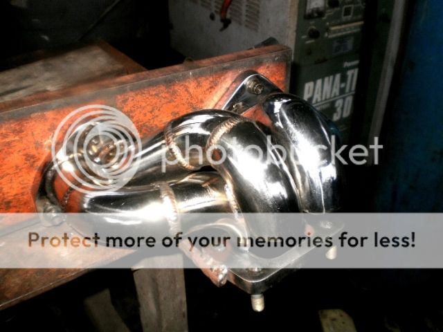

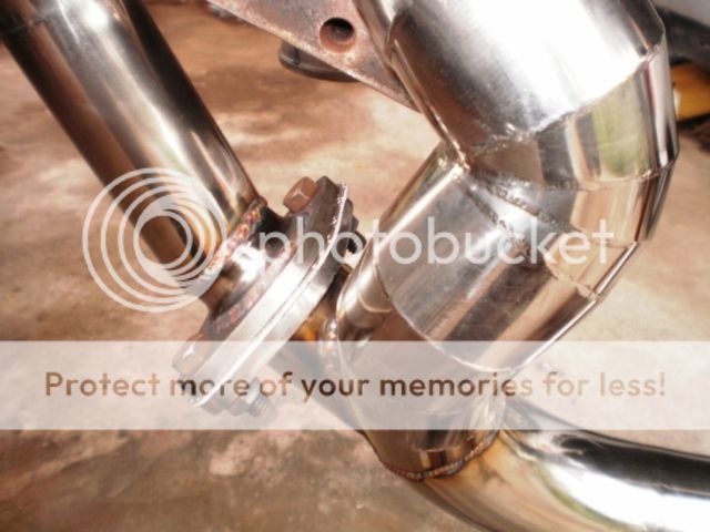

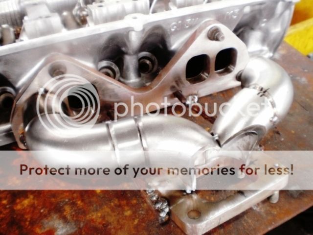

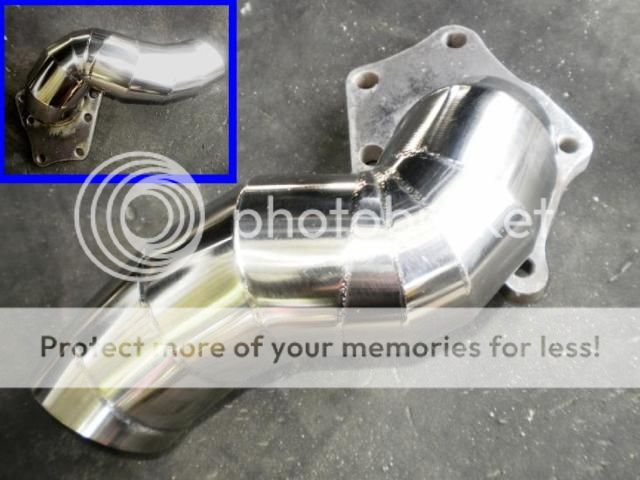

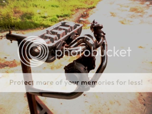

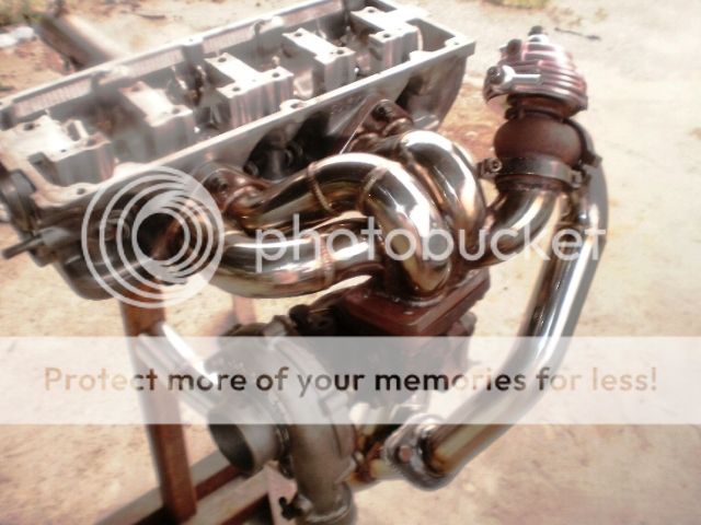

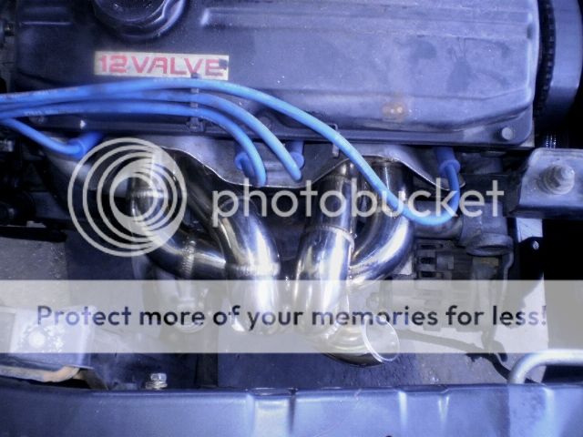

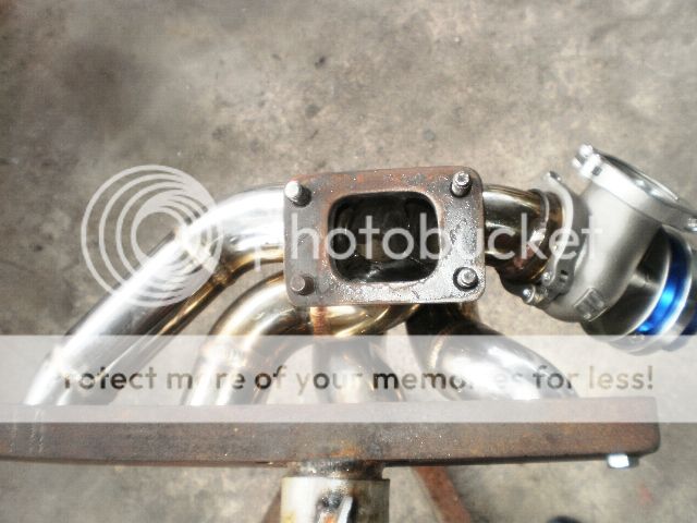

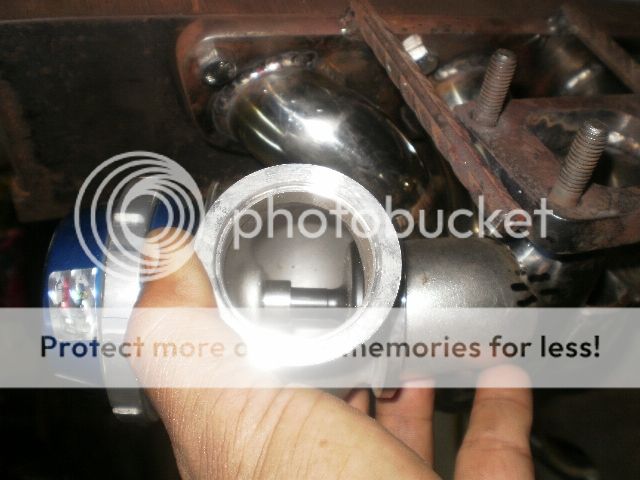

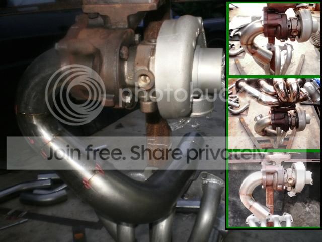

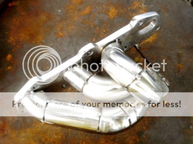

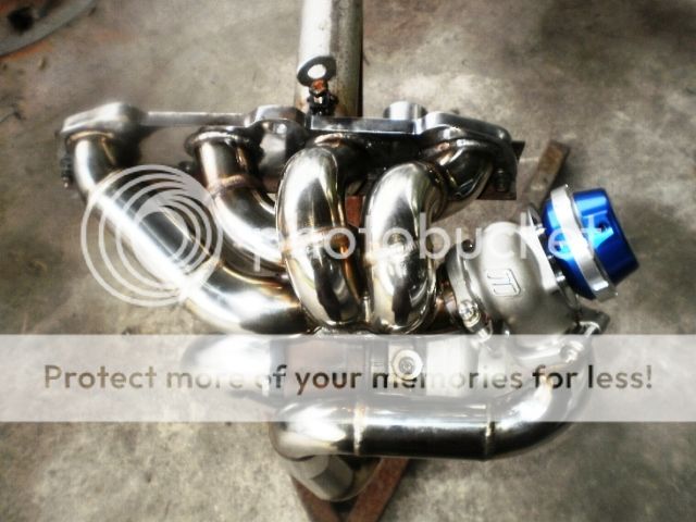

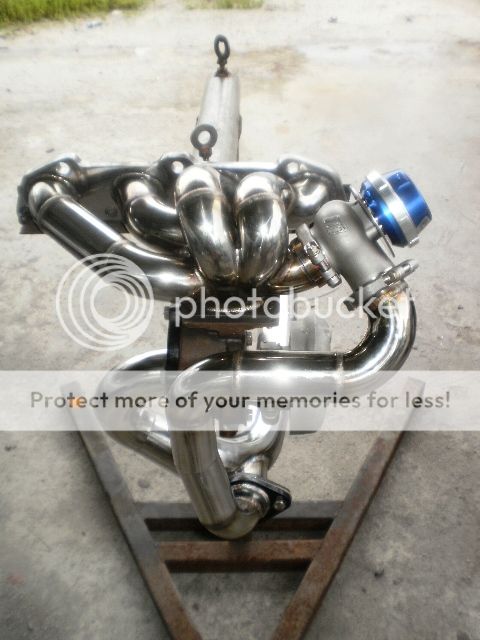

Custom header for Bolt on turbo 4G 1 series...make it for friend,end of last year work.nothing special look.but if to make below then 9" length pipe(out side radius) with tight distance from exs flange to turbo and owner still wants it Banana look...thats the problem... joy 41 pics

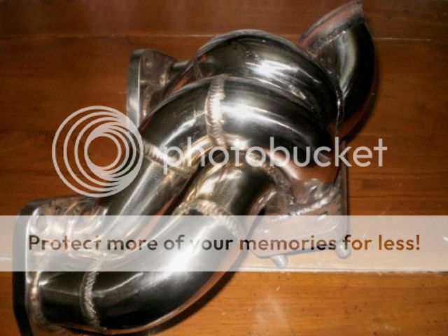

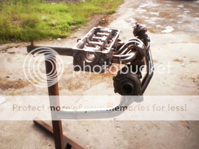

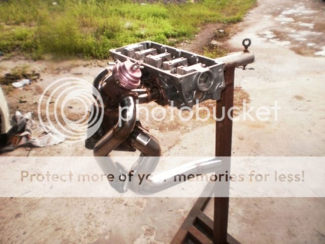

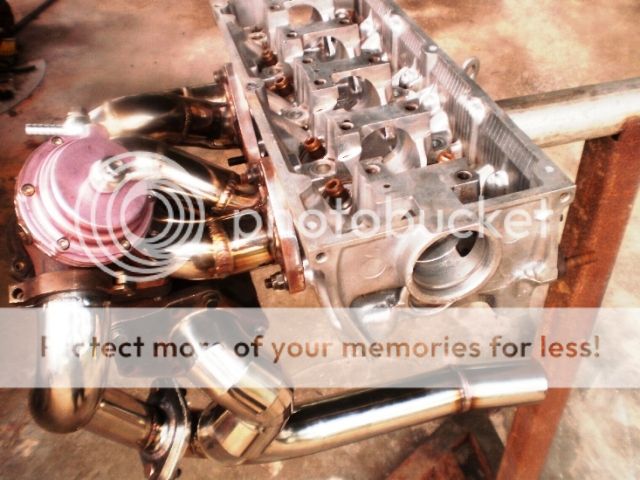

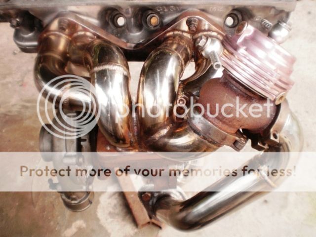

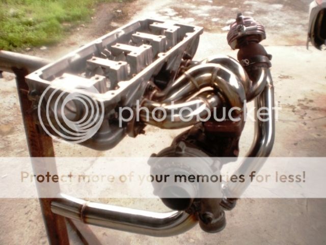

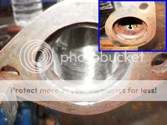

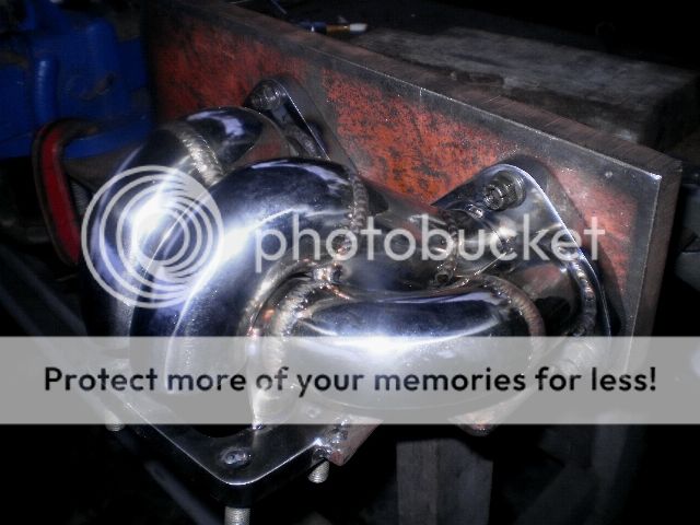

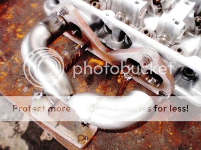

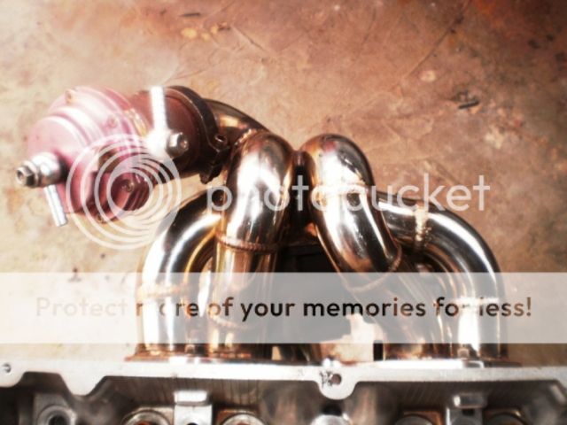

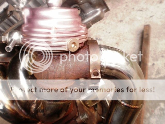

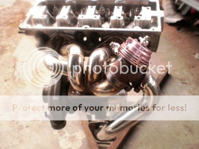

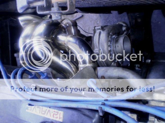

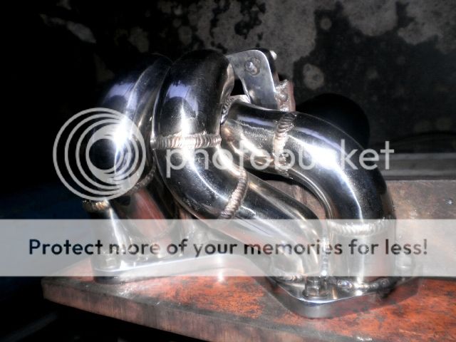

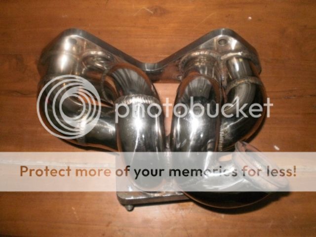

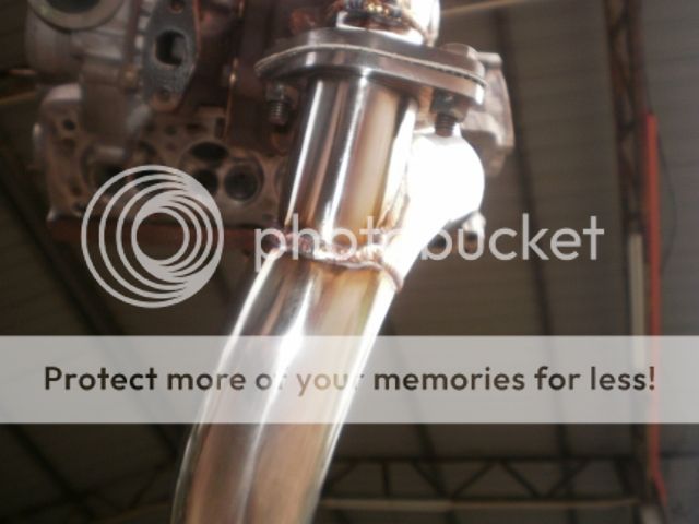

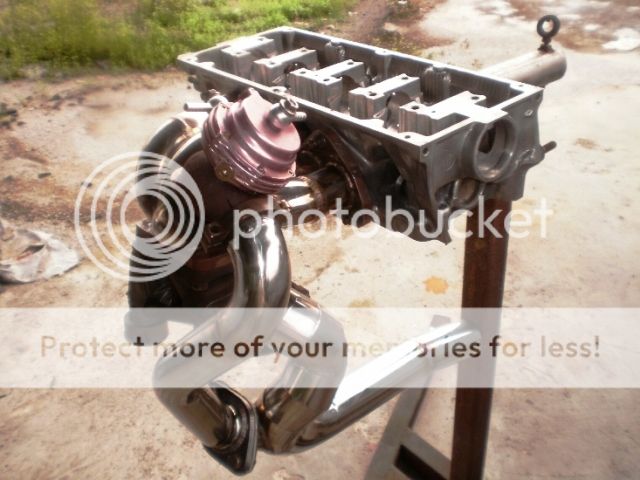

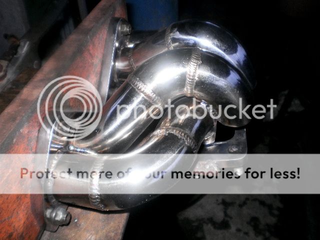

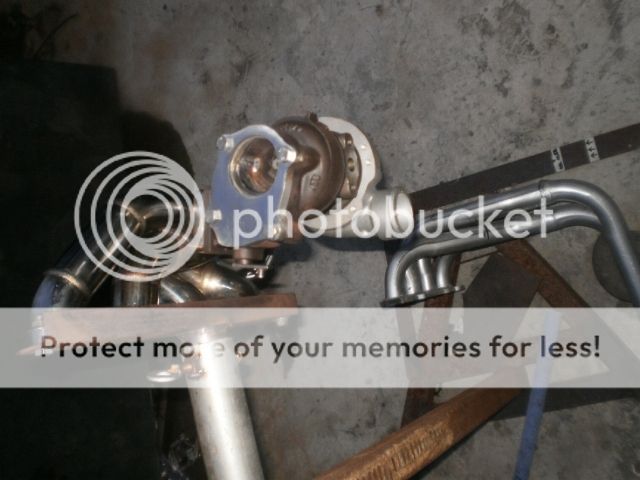

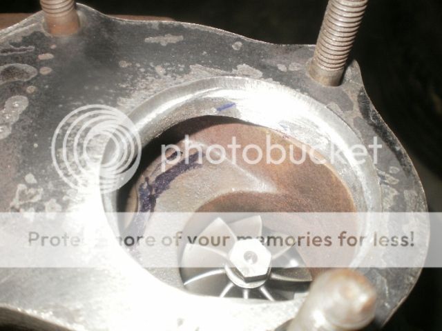

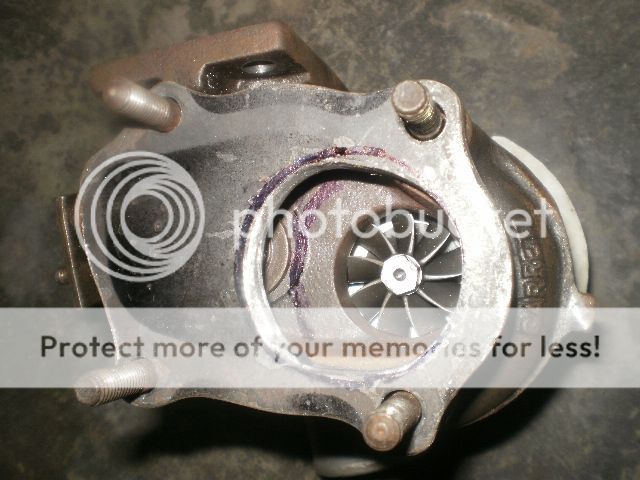

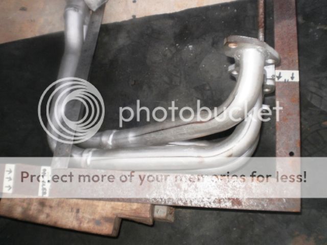

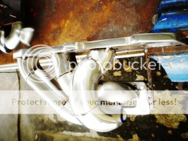

2nd work...custom header for BOT Korean cars...same as above work,but this time without the car for dummy,just using NA header for dummy to get measuring and clearance...that the big challenge...:)- Joy for 42 Pics...

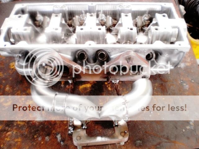

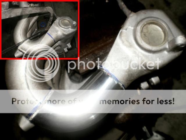

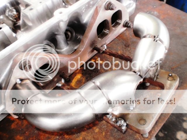

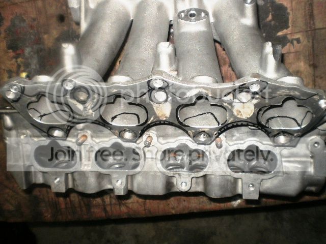

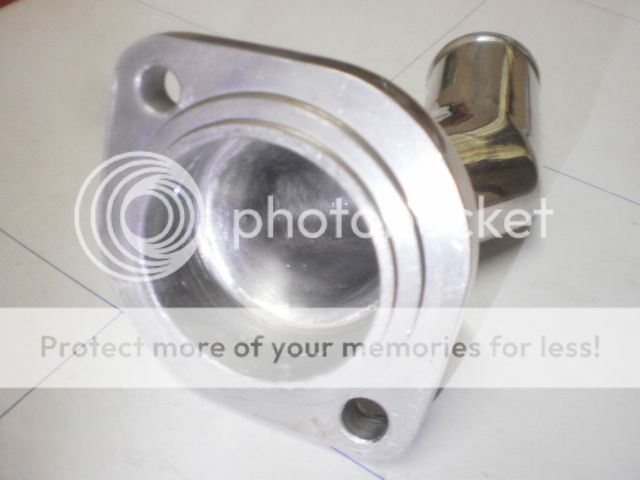

'B Series intake manifold to Mivec head'....this manifold need to mod back..all intake hole is not matching with intake..all stud hole also have been altered by owner... if can move left right,up and down how to know which the right position..hee..he...one question,this intake now already have sale in market right????..dont know why this guys still want to mode its.....For head i need to weld coz owner 'ter'over port till there have one hole...:banghead:
p/s I know this mode already have own thread..and sorry to all..:adore:
Mark using my template...hole need to close and add weld...
What a so big port have here..hemmm:hmmmm:
Tig weld stud hole..
BEFORE....
AFTER.....

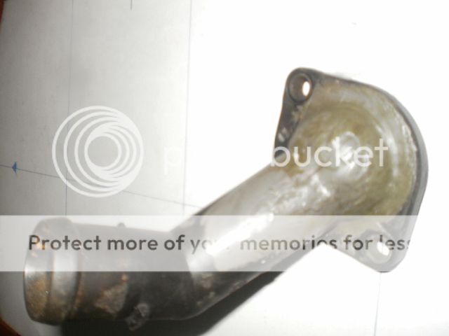

Head Repair....
Only small hole...but for those who deal with Ac Tig weld will know,its not just simply weld..need more prepairation before can weld coz all the hole area must be thin and when its going heat when weld the hole will be more and more big...so how?..........
After weld..port
Test leak or crack...
After for hours no red dot or line mark...so no leak or crack...done:sleep:

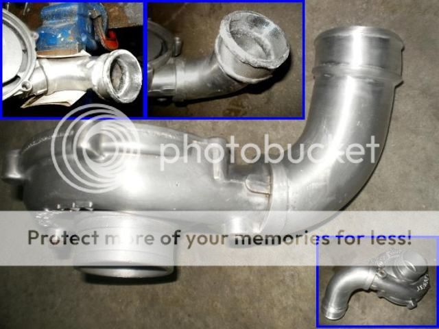

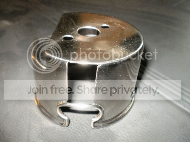

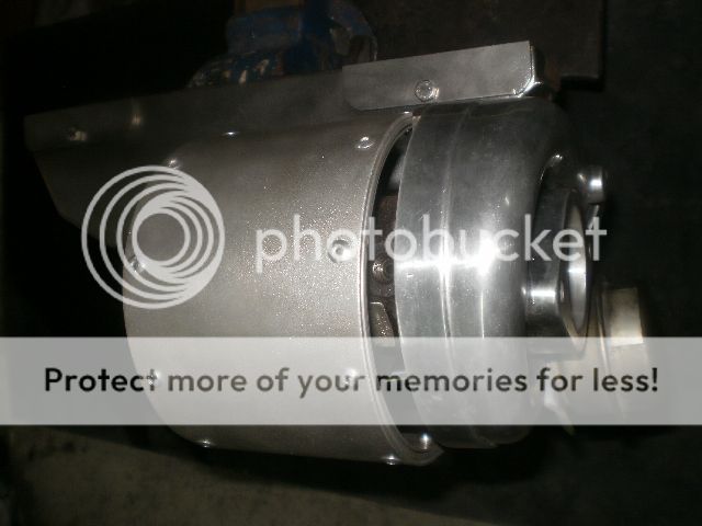

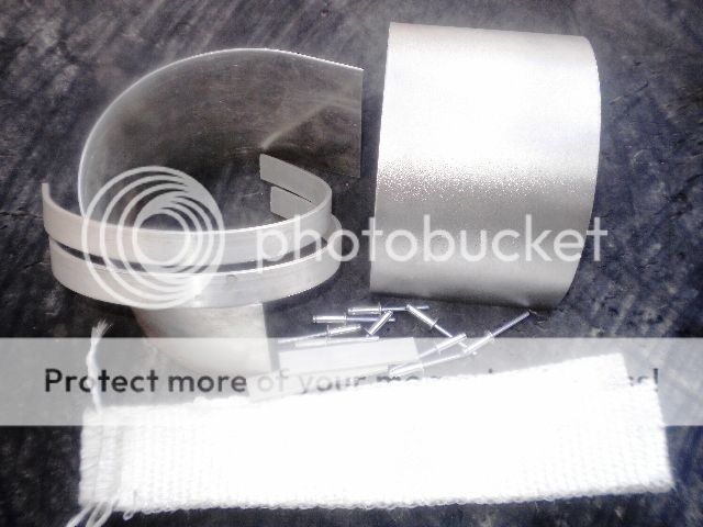

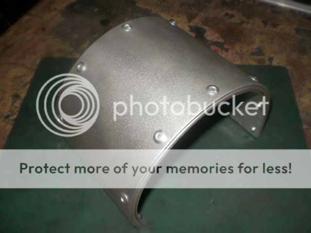

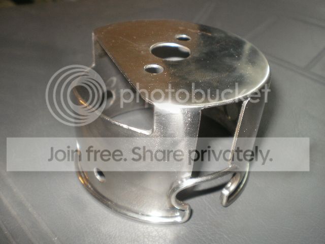

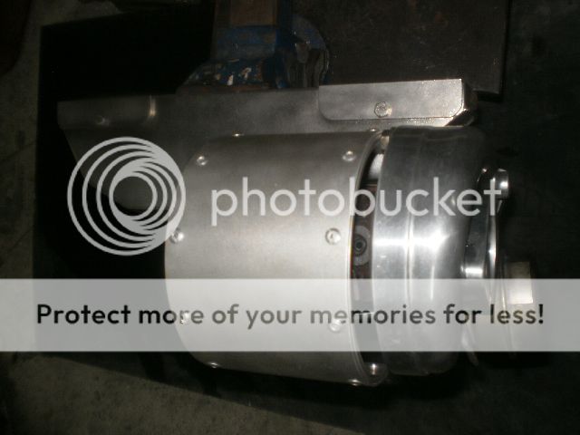

"Heat Shield" - Sorry,don't know what to name its...nothing special work,just for acc..its for mazda in my detailing thread...a lot of pic i need to post there but still don't have time...here some of them...joy for 15 pic:-
