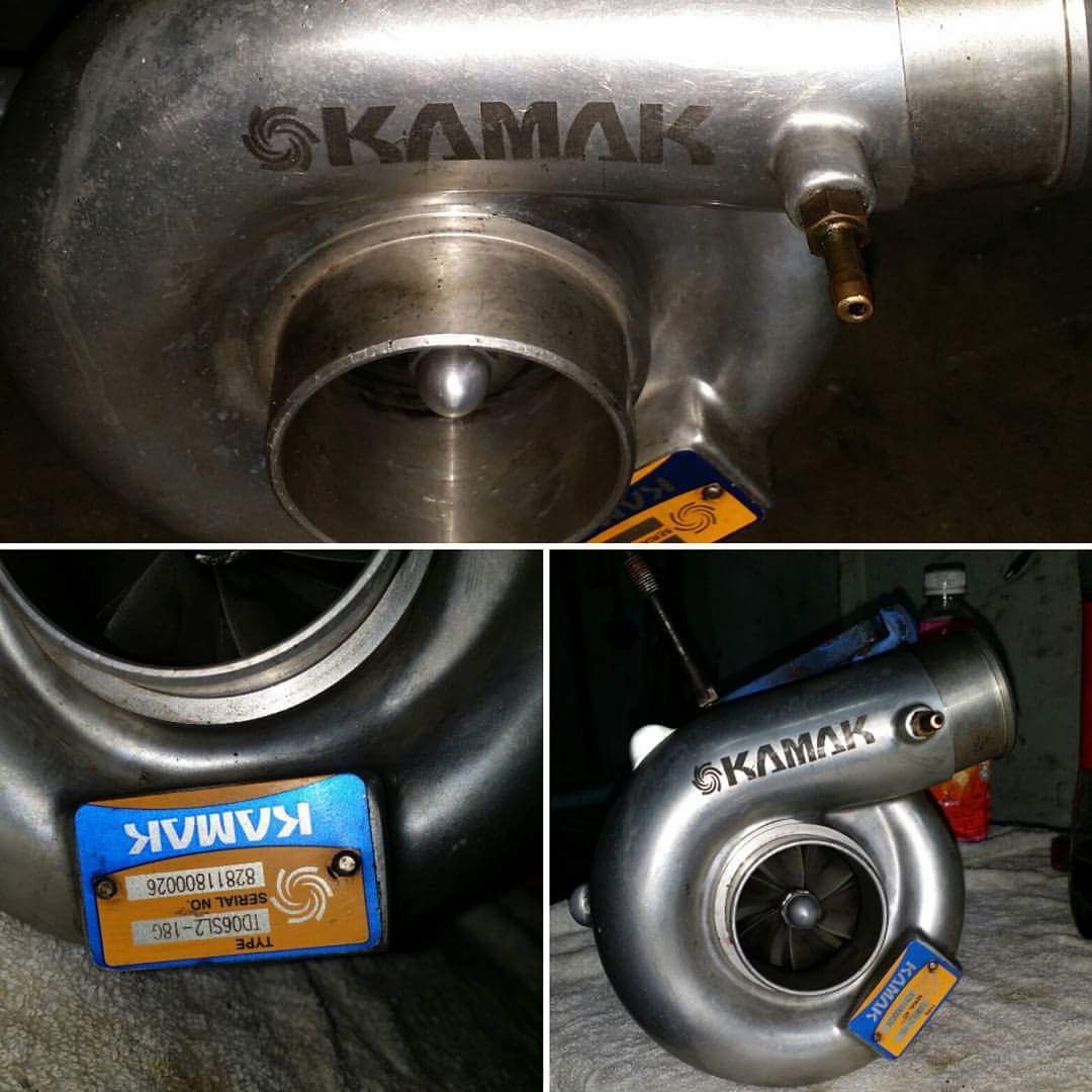

ok, after a few month of hard saving.
I finally got RM1.5k which remitted to my mechanic, will be sending the car next Saturday.
bought my own engine oil, shell helix, coolant, gear oil, spark plug & silicon drive shaft cap if need to be replaced.
a kamak td06 18g.
I told him to work within RM1.5k, nothing more as I don't have money for it unless really necessary.
Wish me luck..
a kamak td06 18g.
Wish me luck..
