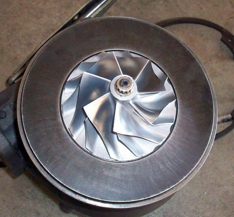

TD05 16g turbo dying soon, from 1 bar to now 0.8 bar

I'm thinking of saving cost, wait until turbo is really dead then replace.
what would be a good replacement for TD05 16g?
