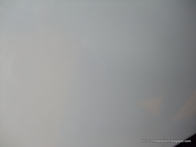

close up
closer - bugs & Insect saps
lower - dust
saps residue, can be quite disastrous if it is not dealt with immediately - as our clear coat is porous...**
insects - saps

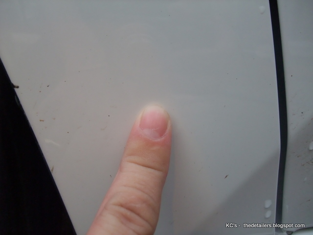

pls be warn not to use force or allowed any car wash guys to use sponges to scrubs like dishes - as it will smears & marred our paint surface
the horror of finding tree sap on our car! The trick is not to neglect your finish by letting it set.
visible thumb print

Heavy, dried sap drips may not be removed if dried onto the surface!** Always remove anything that doesn't belong on your finish immediately! I thought I would have to wash, my car a couple of times with soap and water. Nope - but with the convenience of ONR now, I can just deal with this within minutes
after ONR
