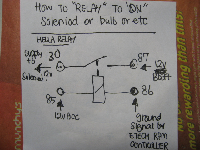

If used as launch function (rev cut)...
Some of you like the concept because sounds nice at traffic lights or stops,
where you can full throttle and pa pa pa pa pa pa pa pa....
Another option for those with hondas ... P08/P30 ecu
Below is a chip for std B16A use which include these....beside fuel/ign up...
Vtec- 5600
Rev cut- 8800
Launch- 4500
S/light 8000
No Speed cut..

In addition, you would basically need a std automotive 12V relay..

you maybe put relay on the +ve wire to the coil right .... the shiflamp rpm output to control the relay right??? so you just set the rpm setpoint, the relay will break the circuit when it touch the rpm... so you will cut power to the coil... is that right??

That 's basic idea plus resistors.(like MSD)- org kelate kata resistoR batuuuuu

owh.... with resistor ..... so the spark still there while relay energize ?? just weak spark??
can share with me your circuit diagram??? ehehhehe..
conrod bearing lah ... i tot you just shut off coil power at hi rpm for that... hi rpm + coil power on than off than on than off.... sakit jugak kalau camtu....
if haltech launch control.... can set soft cut.... it will retard ign timing + fuel enrichment to ensure engine to take to much abused...
