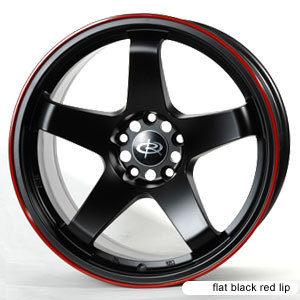

I'm planning to get a new wheels for my Evo7. When I search on line, there's Rota P45 & P45R. Are P45 and P45R the same thing?(They look the same to me).
I'm planning to get ROTA P45 18x9.5 +30.. (Picture) with 245/40/18 tires.
And I already lowered my Evo with Tein S.Tech spring..
Will it go direct fit to my evo?
Do i need any spacer for this?
Please Advise

its all in the offset of the rim whether it will fit nicely and functions well like the stock rim.. the evo7 stock offset is 38 if i remember correctly.. 8.5width is the ideal size for functionality.. 9inch -9.5 will snug the rim to the outer side which will have fender scrub problems, but can still fit by rolling the fenders n the use of coilovers with negative chambers to fit..

Width is too big and weight is too heavy. No point to sacrifice 1-3 second for pickup and more fuel consumption in all range for street use. Those cheap Taiwan replica may do a lot better. 1 wheel 1KG will transform about 20+kg on car weight. A good set of 225/40/18 street tires (example T1R) is good for high speed cornering at 170-190km/h (genting sempah). 245 is just over kill.
