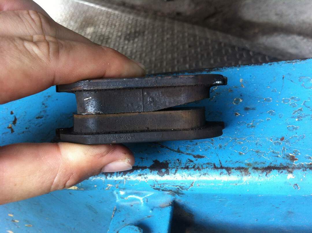

Hello, would like to ask the sifu's here, how could it possibly be my rear brake pad eats only 1 side?? Will post photo soon

the floating pin jammed already....

Anyway it is warranted, new guy installed it when I replace my rear disk rotor and the brake pads
Wow! that is weird. As first I thought you mean one pad wearing faster then the other.....
