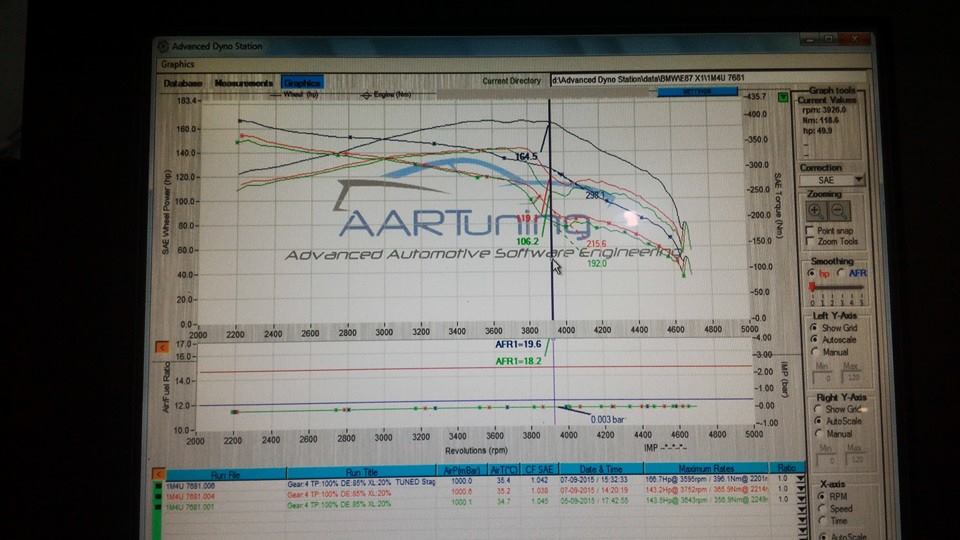

I would like to ask regarding the ECU. I recently had just did a remap and reached about 164.5BHP Wheels power which is on dyno. Before the remap was around 140BHP+ wheels power.
The current car I am using and driving is BMW X1 xdrive 20d, which they state 184BHP engine I guess, so my current concern is that it seems my car is abnormal before remap. I think i lost the remap settings too, seems like power went down as I tried 0-100 on that day of remap was 7.4s, but it dropped to 8.5s now which is even worse than the stock/factory 0-100 which is rated at 8.1
Thanks,
please look at the dyno chart below for my before and after.
Cheers, hope someone will reach me and clear my doubts.

HP/TQ rated by manufacturer was all from flywheel...
which if u get your calculator ready...just around 75-80% from that amount gets delivered to the wheel.... the rest goes missing as sound, friction and heat in the transmission....
184hp X 0.75 = 138hp which when dyno u got around 140hp was absalutely spot on.....
a remap usually comes with increase of boost, more fuelling and more injector firing timing..perhaps u need to double check your new map....maybe too aggressive and losing power

@Izso
Hello Izso,
I will check out with the remapper. I did ask him though but he told me that there's no way remap will be changed or something. So it could be different, and each dyno costs me 250 >.<

How actually did you remap your ECU, using piggy back ECU or direct mapping into the original ECU?
If using piggy back, then it might be possible that your ECU relearn back the original mapping hence in practice bypassing the modified map from your piggy back. That's why now it returns back to like before.
