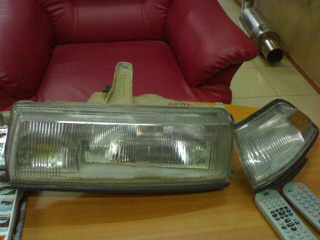

I found out this at half cut there, I look it seem like AE92 head lamp. But it still abit not same as ours 4 door AE92.... Anyone know about this lamp? It is from which model? Need to mod to it our AE92?

that one ae92 levin of coz not same. ours shorter than levin head lamp. scomatic u r sifoos right. dont acting like that la...

I'm not sifoo la... this lamp is Levin AE92? I really dunno where it come from.... I though it same as our local AE92 le... haha...

yup...this levin type head light...if u want to fix it...need to change many things....like grill , fender..

yup...levin punya...i got 1 set at my home too... haven't convert also..i got complete set..like bumber,grill,bonnet and fenders too... hehehehe

yup..dat 1 is from levin..beza die sbb ade small yellow lamp wif head lamp..local ae90/92 biase pakai lampu biase je...sco,pakai smoke headlamp la....taiwan made just 450 je...hehe..kontek karlok..

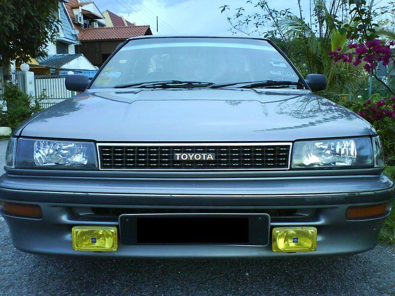

maybe go to smoke head light....if interested contact AE101-Wong.....
the picture is not my car.....

sco..the set u bought r from ae92 2doors...diff is its longer then std ae92 4doors version coz it got fog lamp....n this set if wanna fix to ur car...need to buy the grill oso....
Wanna fix this set....??? 2 way....either mod ur original lamp bracket...or buy complete front part from ae92 2doors n fix it wif ur old fender...means "kawin" fender. Use 2doors n 4doors fender 2gether. this 1 need more money laa...front part+labour charge+respray. If not just mod the old bracket lamp...for me..find the good ketuk body guy n fix it...:biggrin:

Not your car ka? very pretty le...

Not yet buy le... i just take for sample only...
