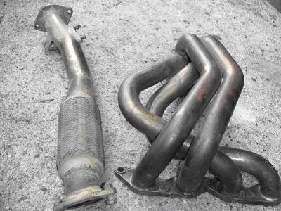

Hi sifus, i got a question, im not quite sure about my current exhaust mods cant trust those exhaust shops guys la, can anyone advise me on my current setup? Tried modifying few times till running out of ideas
Last time use to have two bullets but now replace with midbox some how feels better pick up! so now my setup is 4-2-1---Bullet----midbox------s-flow muffler

I think 1.6" piping is too big la coz i losing low end and fc quite high. Any recommendation? :confused_smile:

I took out the front bullet and replace it with straight piping to the midbox, car feels so much better, dono why some how got jampi by the exhaust shop to add one more bullet :X-: fullish me. i guess too much backpressure till car lost power.
