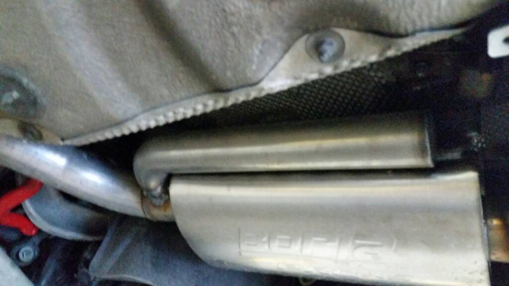

Guys,
I have a 3" straight flow exhaust setup on my turbo car. I have a mid-box resonator (pretty large one and is straight flow) and a pretty large straight flow rear muffler. But it's still loud and the droning at 2.6-3k rpm is killing me since I'm in that rev range a lot.
I've been reading up about side-branch resonators and helmholtz resonators. It's those weird branch exhaust add-ons that apparently take away the droning by cancelling out certain frequencies depending on length of the resonator.
Anyone tried this with positive results?

my suggestion is better and cheaper to go with dual resonator instead...
this frequency tune especially exhaust require a lot of trial and error...

I have seen Adam LZ doing this on his 350z, dual. Useless. Apparently well known brand still.
Well known brand? Didn't know there's branded resonators out there. It didn't help to reduce the drone for Adam LZ? I'll go google this.
Well, if I can't fit another reso then I won't really have much of a choice. Trial and error is scary

no cuz I need 3".. that's 2" only.
i got a suggestion... find a place where lorry/busses do their exhaust... those kind of shop can custom muffler?resonator according to your size...small or big also can...
coz 3" is common for lorry and busses...
downside is probably come in normal mild steel...no SS material..

Let's see how it goes. Until I get the car back I won't know how best to proceed.
