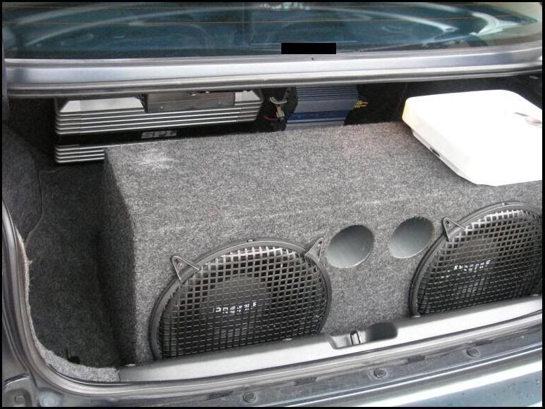

I bought a car with ICE built by previous owner, but i dun like his setting because i found that the bass is too heavy (10" woofer x 2), and the weight of woofer box is 30kg, which is a lot for me. So, i'm planning to take out 1 of the woofer, since my friend wish to buy it.
The question is, can i just simply take out 1 woofer without re-routing the wiring or adjust something else e.g amplifier?

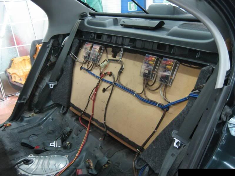

what is the big "SPL" thing at left hand side in pic 1? and what are the 4 boxes in picture 2? i'm really a newbie, dun shoot me, k? :_:

the big SPL thing is an amplifier and the 4 small boxes are called passive crossovers, i guess u have 2 sets of component speakers.
for your sub, u have to take out both subwoofers from the box and get individual boxes for each, cant take out one and leave it. the wiring to the sub will be simpler than wiring 2 subs, so theres no problem if a shop does it. if u want to DIY have to find out if the sub has 1 set or 2 sets of positive/negative terminals, if 1 set its very simple, if 2 sets, have to wire it in series or parallel to get the correct impedance. will explain to u more if that is the case later.

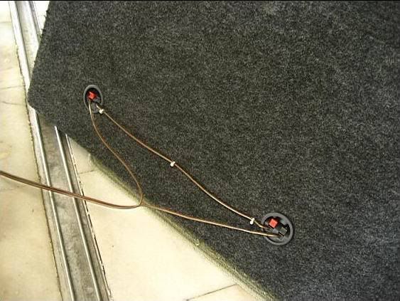

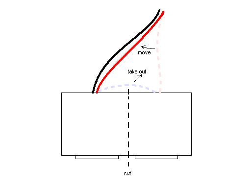

Here is the photo of the wire connection, is this the "1 set" u mentioned before?
That's mean i can just take out the short wire, and then connect both terminals to the same woofer (Pic 2)?

Yup its the correct way to connect the wire as in your pic
Ok, ryukeong, thanks for ur advice :_:

if youre experienced in box building, then you could do the cut n paste of the box (have to paste one more wall for the box that doesnt get the middle splitter), just make sure everything is strong, tight & rigid.
the wiring outside the box is series, which makes me think again that there may be another double voice coil wiring INSIDE the box. u will know once u open it, if it is a single or double voice coil sub. if it is indeed single (one pair of +ve -ve terminal) then your wiring diagram proposal is ok. if it is dvc (i think its parallel inside, series outside) then u may or may not change it depending on your amp specs (if it is 2ohm mono stable or not)
Yah, in fact i should prepare proper tools b4 start work, and make sure the cutting edge is smooth and nice. Happy DIY :_:
I did open up the woofer box and found that the wire is connected from woofer to connector at the box. That's mean there is no connection between 2 woofers.
