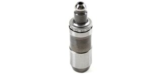

Sifu's out there....need some advise....i intend to replace the hydraulic lifters in my 4G93T with new ones from the proton 4g93 NA...would there be any diffrence? how about the durabiity? Thanks in advance...

if its making tik tik tik noise...its not the lifters (unless ur engine has been overheated and seized prior to this). NOTE: Hydraulic lifters are an ingenious design and RARELY fail.
problem lies with oil pump...specifically relief valve spring. Spring tension low resulting in oil flowing back to oil pan and top engine starved of oil resulting in lifters collapsed.
I've solved mine on a mazda engine.

Jun, no they are OEM. Performance/aftermarket ones have to order/buy elsewhere.
Mitsu lifters are well known for their ticking noise. From 1st gens all the way to the latest evos. Its just a flaw/quirk of the engine. My current motor has over 7bar of oil pressure at full flight and 2bar at idle and it still tick and thats with a big oil cooler. It can be solved buy getting updated lifters with the 3mm opening. This was proven when these was installed on a frens car recently. Super quiet can only hear the fan running. :)

alucard, dat big oil cooler is decreasing the oil pressure to the head. where do u tap the sensor for the oil pressure meter? i think its an oil pump problem also, as mine isnt ticking on revv, just a lil on idle jer

xtremeleo, its not an oil pump problem if you have sufficient pressure when driving. Just the lifters. Mitsu is well documented and common to have low oil pressure at idle and I've been living with mine for years without probs to then engine. Even if you have a new uprated pump it is still the same oil pressure la. Tried that.
For that oil cooler my car's oil pump housing has a thermostat. So oil pressure when cold is not an issue. ;)

Jun, These are the lifters Bro Alucard is mentioning...
Check the website below
http://www.meek.com.au/index.php?act=viewProd&productId=168

Anyway, Jun. These are in AUD and they are gonna be quite expensive now since AUD is 3x MYR. That excludes shipping. I got a few sets for myself and my bros last time. The folks in Meek is nice they will ship to you.
