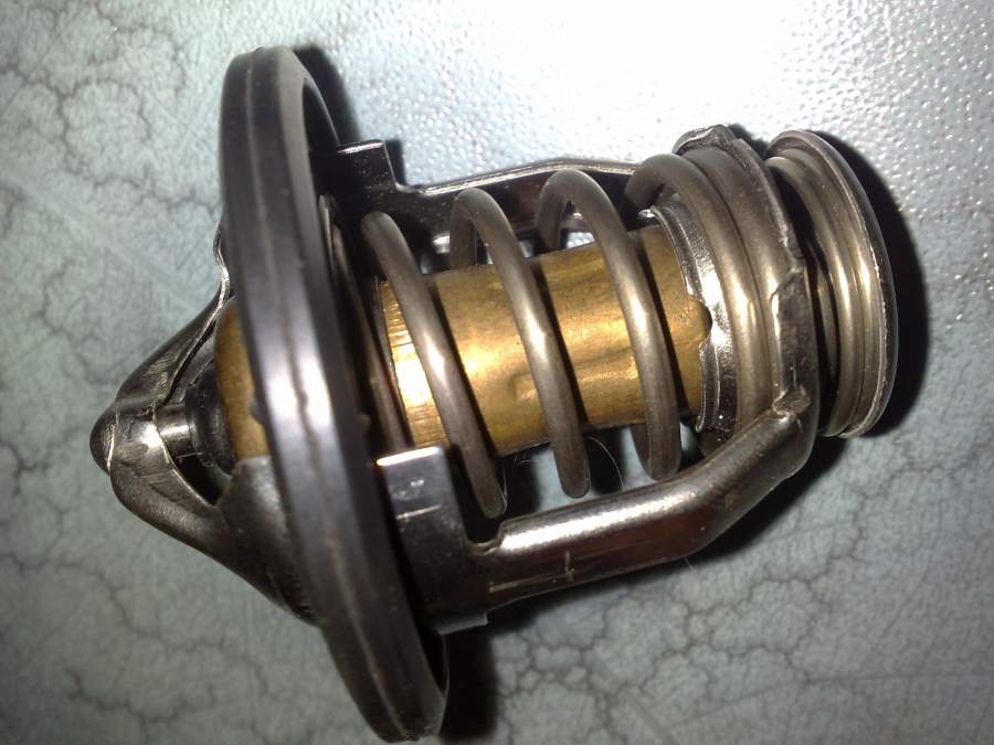

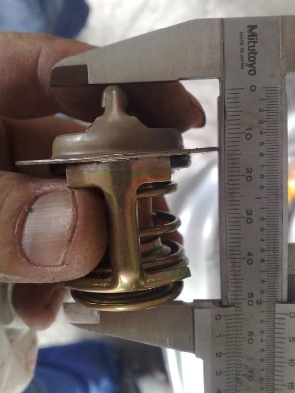

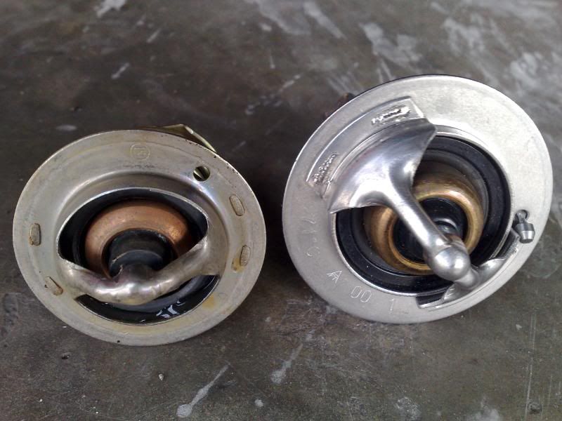

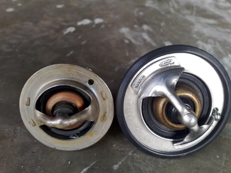

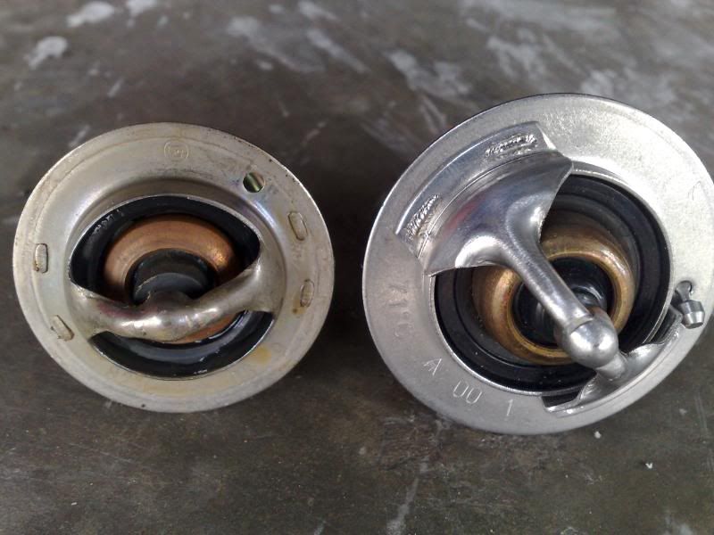

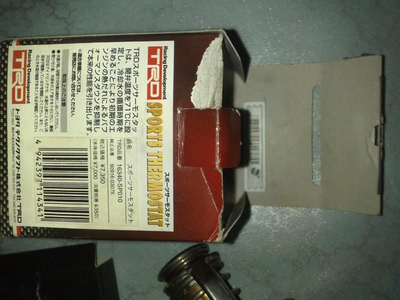

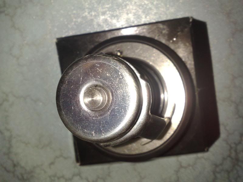

Hi Bros,
I bought a thermostat last year from a seller here who's actively selling parts but didn't reply to my queries. I may have been my fault due to it being a long time but to my defense, I asked him many times if it could/would fit for my car since I'm not a mech and I don't know how it looks like exactly. He replied assuring that it was meant for a 4age 20V SVT.
The reason why I took a long time to install was I thought I'd do everything at one go. ie; change radiator, silicone hoses & water temp. But when I tried to fit in the thermostat, it was totally different from the stock one.
I have NO IDEA which thermostat is this for and am seeking someone to let me know so that I can sell it off cheap! cheap! :proud:

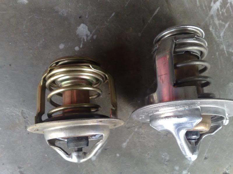

Left is stock 4age svt..right is the one i bought...

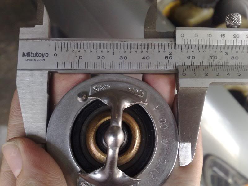

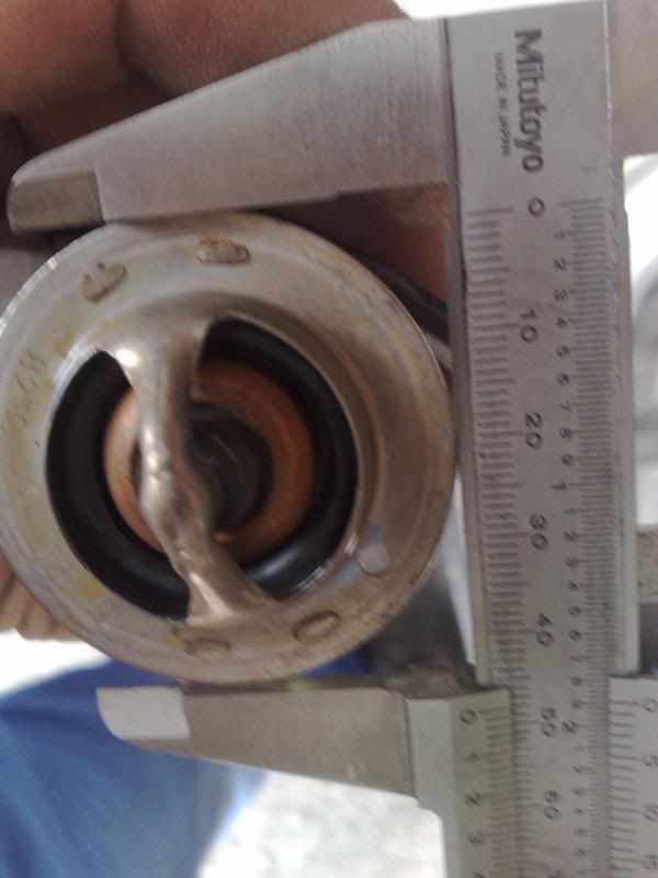

Hi bro,
The thermostat you buy is for 4AGE 20V BLACKTOP only, also suits other 3-S SW20. Many people
didn`t realize that 20V silvertop housing is smaller than blacktop.
So you need to get 4AGE 16V thermostat instead of 20V.
Hope that helps :)

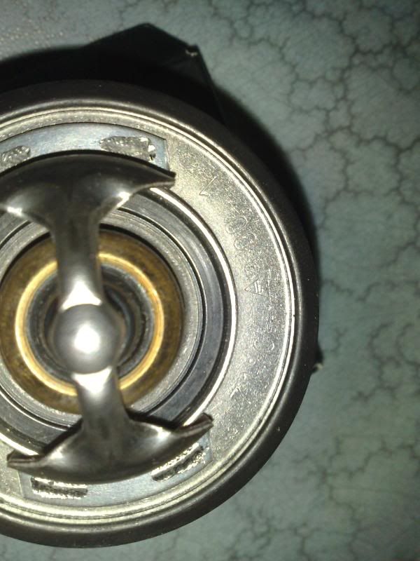

will u sell me cheap cheap? I know it for what car already~:rofl:
The TRD thermostat didn't wrote any TRD word on it, but it got wrote the code on it.

Thanks all! Didn't know that there was a difference in SVT and BT thermostat.
I refered to Chin's blog and it also states that it's interchangeable...
:: 4age Part Number
90916-03060 THERMOSTAT 01.06.1991-01.05.1995 4AG#..AE101;*WAX 82-95
Thermostat 90916-03090 All 4A
So which is SVT's part number?

So does it mean that I'll have to look for 4age 16v (doesn't matter if it's RW/FW?) for the svt low temp thermostat? Thanks in advance..
---------- Post added 03-16-2010 at 01:48 AM ---------- 6 hour anti-bump limit - Previous post was 03-15-2010 at 11:01 PM ----------
Found this that had both part numbers..
4AGE 20v Parts Numbers (Black and Sivlertop) - TuneMyToyota.com
Blacktop Thermostat: 90916-03075
Silvertop Thermostat: 90916-03060

Should be the same for 16V RW/FW, since it`s also suits FW 4A-FE. You can bring current thermostat and compare~heee
From what I understand, maybe it`s interchangeable within the same engine but different chassis.By saying 4A is too general....might can be 4A-FE, 4AGE, 4AGEU?!....even in the TRD catalog also not stated details wther the thermostat is suits either 20V SVT or BT.....4AGE FWD/RWD :confused:

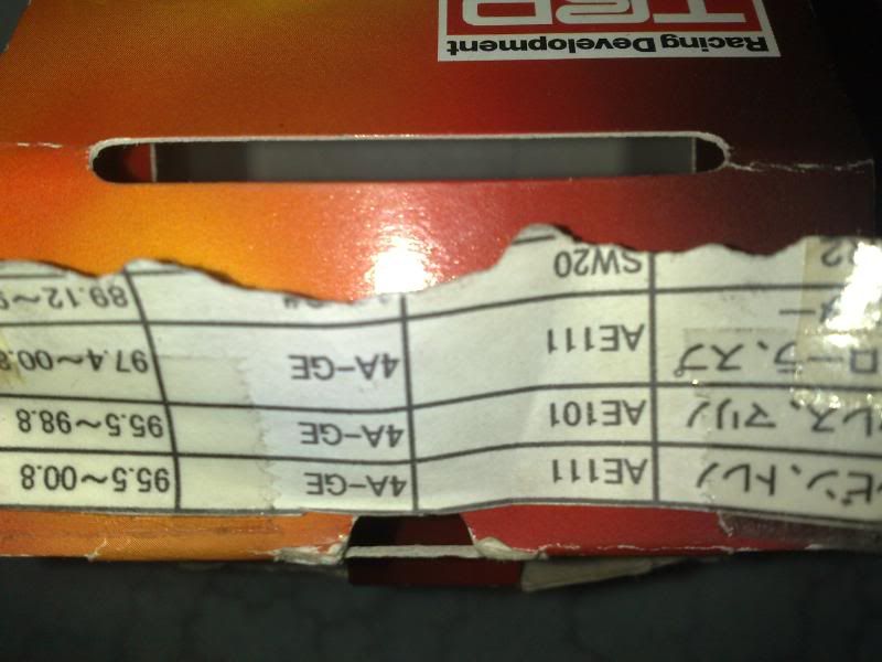

Yeah saw that stated for both AE111, need to inquiry direct to knw which engine. This is what from TRD :
http://www.trdparts.jp/english/parts_thermostat.html
AE101 for 4AFE engine, AE111 for 4AGE , AE11# for 4AFE

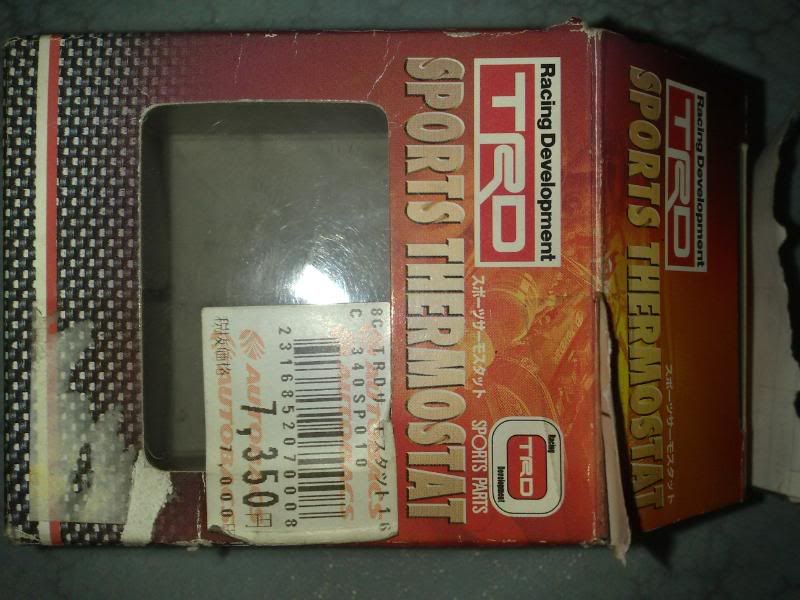

Funny that it doesn't have for the part no. 90916-03090
Adapted No. TRD Part No. Code Toyota Genuine Part No. List Price(JPY)
1 16340-SP000 C 90916-03046 7,300
2 16340-SP010 C 90916-03075 7,000
3 16340-SP020 C 90916-03093/90916-03126 8,000
4 16340-SP030 C 90916-03100 8,500
5 16340-SP040 C 90916-03122 Discontinued
6 16340-SP050 C 90916-03084/90916-03125 7,000
7 16340-SP060 C 90916-03120 Discontinued
