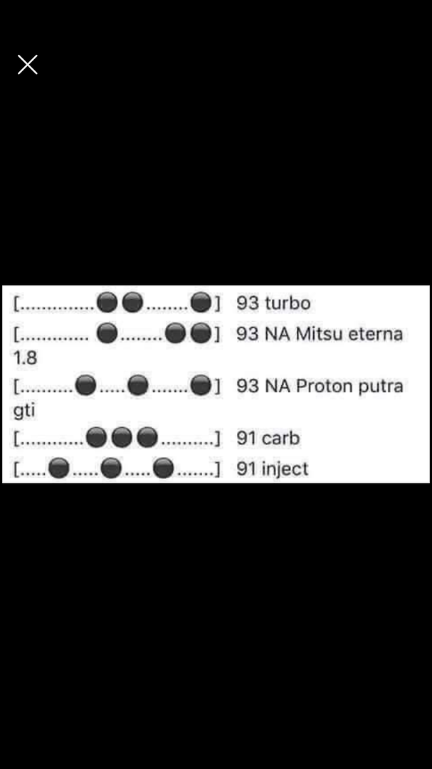

i also need to know this. How and where do we check to see this line to identify what engine we are dealing with, and what about the 92 series engines?
Make friends with your mech and get him to help you check (assuming he knows how to identify). The problem with halfcuts is you'll never know what you're going to get and how much will be needed to fix up the engine before transplanting.
  • Like
Reactions: Ranjanmax
lsm1991
Sep 30, 2011
1,469
185
1,663
PJ
this can only tell you what head it has. On the head, right infront, just over the extractors.... if i remember correctly on its right (facing the car)
block u pandai pandailah....
i hope you know what ur doing, i didnt mention this earlier but i believe one of the links posted by you was that of a newer generation engine, which means its not practical to put into the older protons. thats why its cheaper, cause not much demand.
**take note the newer gen 4g cannot rojak with the older gen parts, its 'terbalik'
