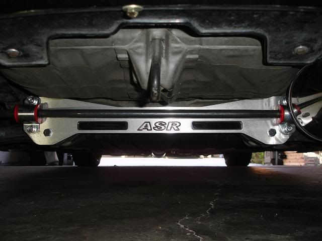

Wah, why did u put EK9 rear ARB in the 1st place, unless you're a regular touge man, or SIC wannabee, no need la bro.
But if you still insist on installing 'em, then like JINEIL2EN said, better check the installation, is it correct or not, And your endlinks, in good condition or not ( since EK9's rear ARB is 21 or 22 mm, I forgot ) as the force from the larger ARB is a lot more than standard ARB.

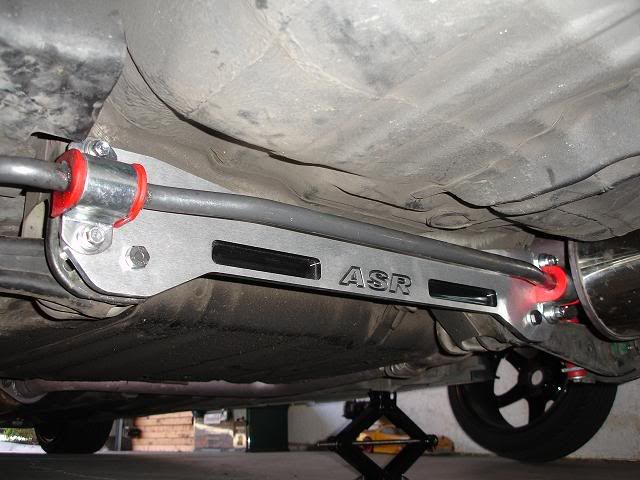

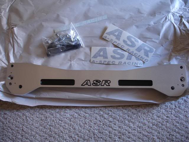

And cOOlric is correct oso, you must reinforce the mounting area via installing some sort of aluminium plate, I don't think it's locally available here, and it's not available at SG oso. You have to order 'em from the States, brand A-Spec Racing ( ASR ) is currently one of the best ones available.

indeed, david. You gotta reinforce the mounting point at the bracket area before you put it on or your chasis will be torn in no time. My friend put it on 4drs before and found out that the chasis was cracked later.

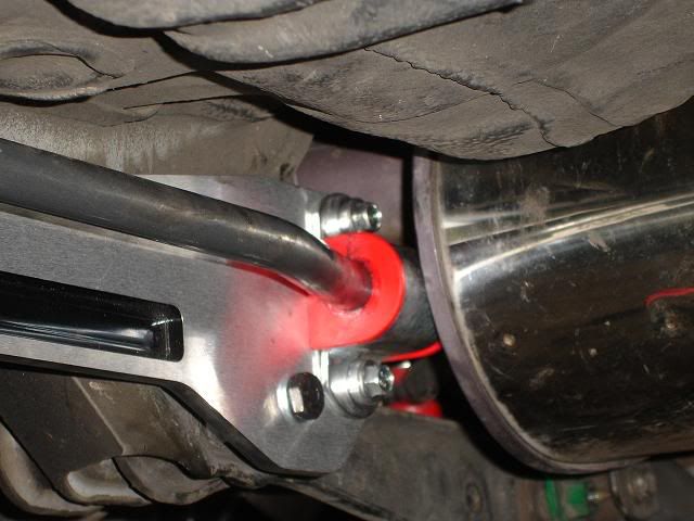

Actually it can be install by upside down, but u hav to put it up most on the chasis bracket by drilling 4 new holes to bolt it in place. Most of my friends hav done it and its ok. I myself oso will be installing it soon. Yes its being proof to tear the chassis if u don't put it upside down or following the type- r order of installation.. cheers Bro!!!!!!!!!!!

EK4 rear ARB should b more than enuf 4 da EK3 chassis. Unless u gonna get da A-Spec Racing ( ASR ) subframe reinforcement braces for most of the popular Honda vehicles. These strengthen your subframe, preventing it from tearing behind the mounting hardware of a large-diameter sway bar by enlarging the contact region between the two as well as limiting torsional force on the subframe sheet metal.
